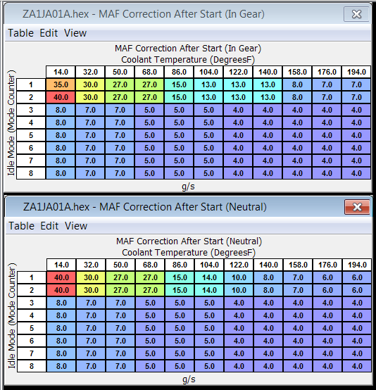

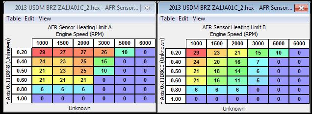

Are we talking about these tables?

Or are talking about these tables (referenced by coolant temp and idle mode)
This one.
Mode 1 is with the engine not running, 2 is the engine during cold start procedure.

Ok, I've implemented into ZA1JA01C, download this definition:
https://raw.github.com/TD-D/SubaruDe...R_ZA1JA01C.xml

They are in the Mass Airflow / Engine Load section.

@troek - what's your CAL id?
Nevermind, I've added to ZA1JA01A, here:
https://raw.github.com/TD-D/SubaruDe...R_ZA1JA01A.xml
