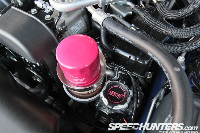

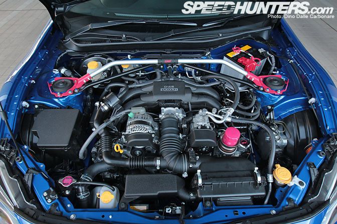

So I was looking for some wheel pictures, when I came across the STI concept car from last year.
Note the Forester DIT oil cooler all setup from Subaru already...

That is a good eye. I wonder how the coolant lines are routed.
Probably simular to how the Forester lines are routed.
