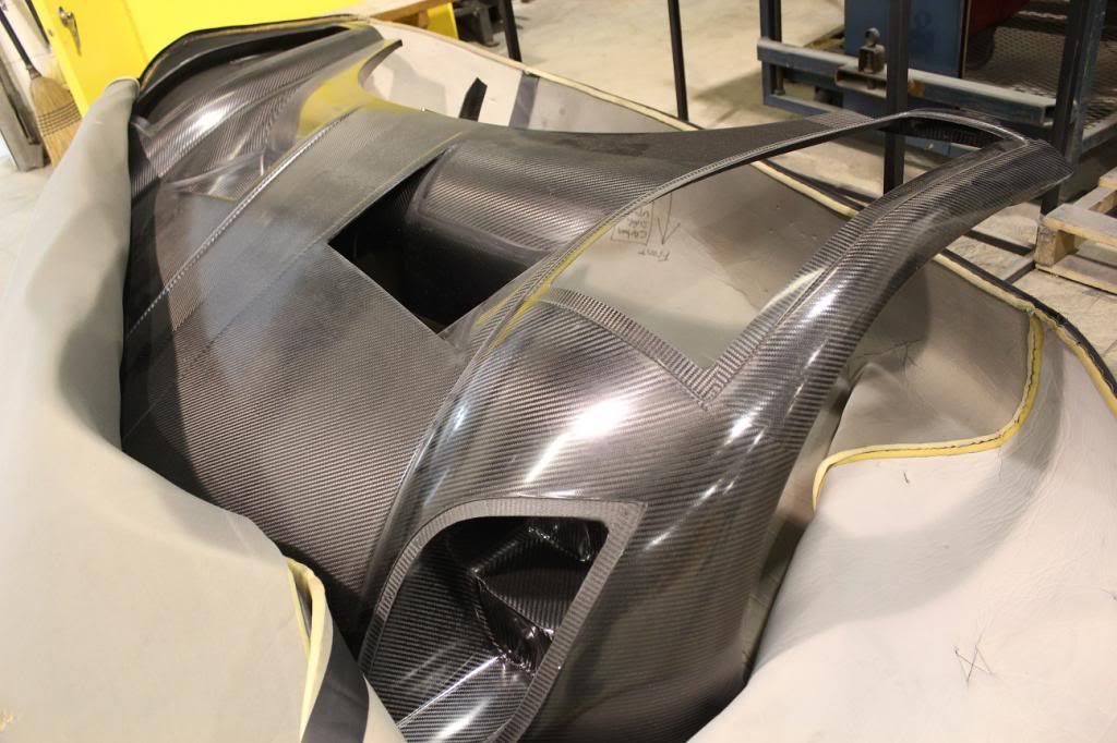

There are not many other manufacturers that can do what our manufacturer does. They regularly do aerospace, military, and motorsport products. I wasn't allowed to take pictures of the military or aerospace stuff, but I was able to take a picture of the front end of a LMP1 car
Looks like a Riley DP (Daytona Prototype) nose, not an LMP1
Alex told me P1 so I wasn't going to argue.
As long as he doesn't show you, what he's not supposed to show you, he can call that nose whatever he wants.

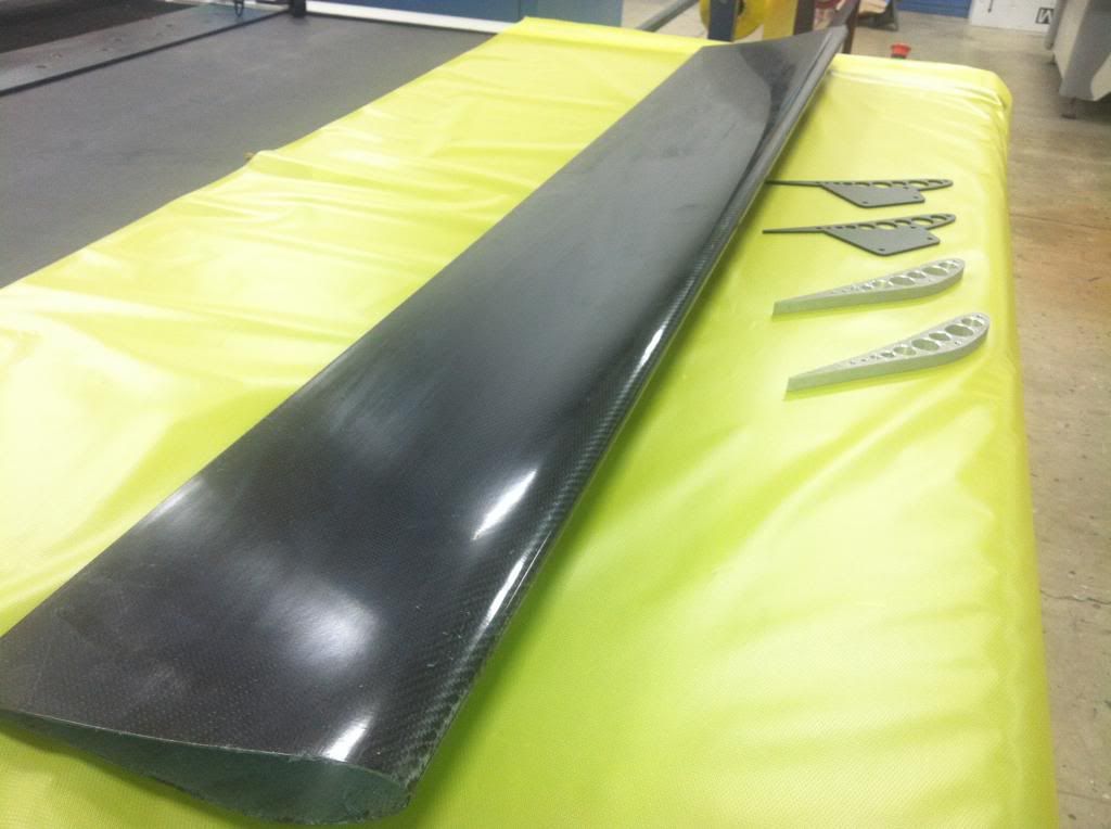

The skin, ribs, and mock-up mounting brackets for the SEW V2

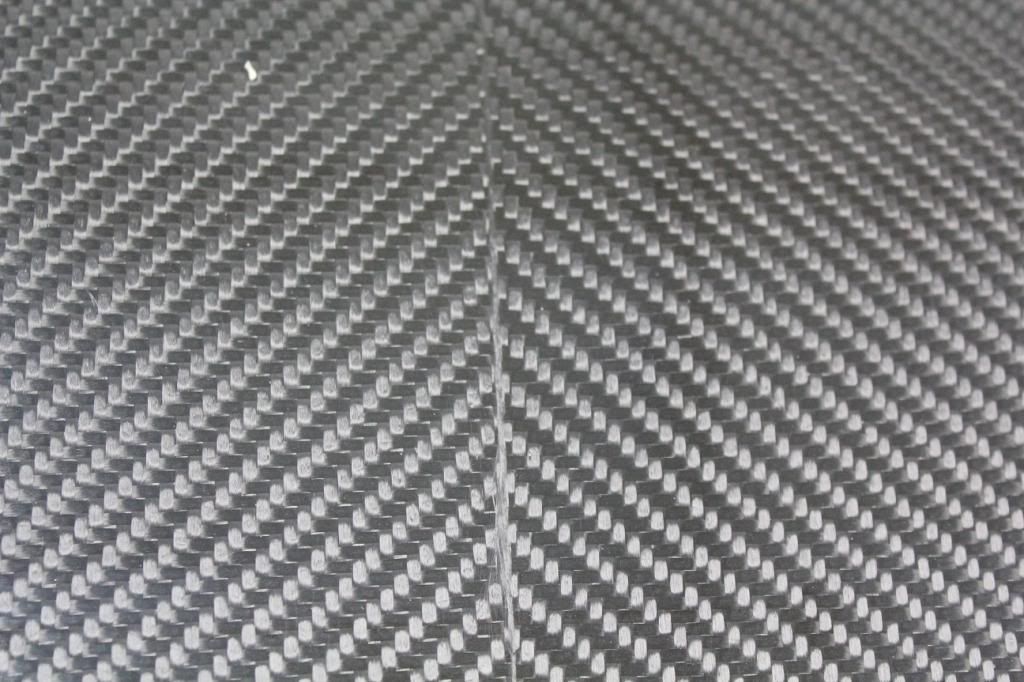

A close up of where the sheets join at the center of the wing
The weave is not lined up because it takes a lot of time and care to do so, which adds to the cost. We can line it up if the customer wants, but it is an additional charge.

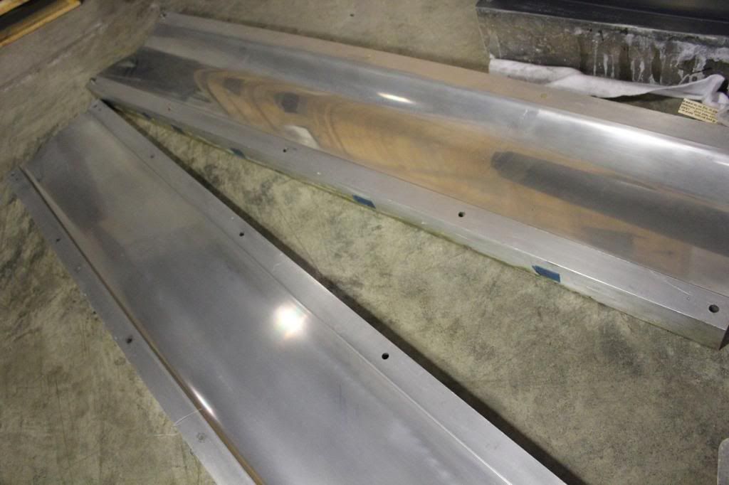

The CNC'd aluminum mold
