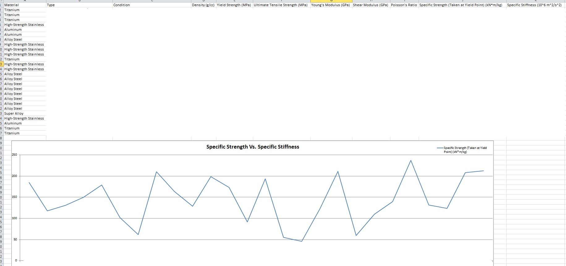

First, we considered the loading conditions the car would see during track conditions. We also considered the case of the wheel smacking a curb. Then we set about finding an appropriate material for the turnbuckle. We took into account stress, displacement, weight, corrosion, fatigue, and cost. We compared materials and designs on how to best meet our design requirements.
We finally settled on aluminum alloy. I cannot name the specific alloy because it is a trade secret, but it is as strong as 2024, with the corrosion resistance of 6061. The design and FEA is the easy part.

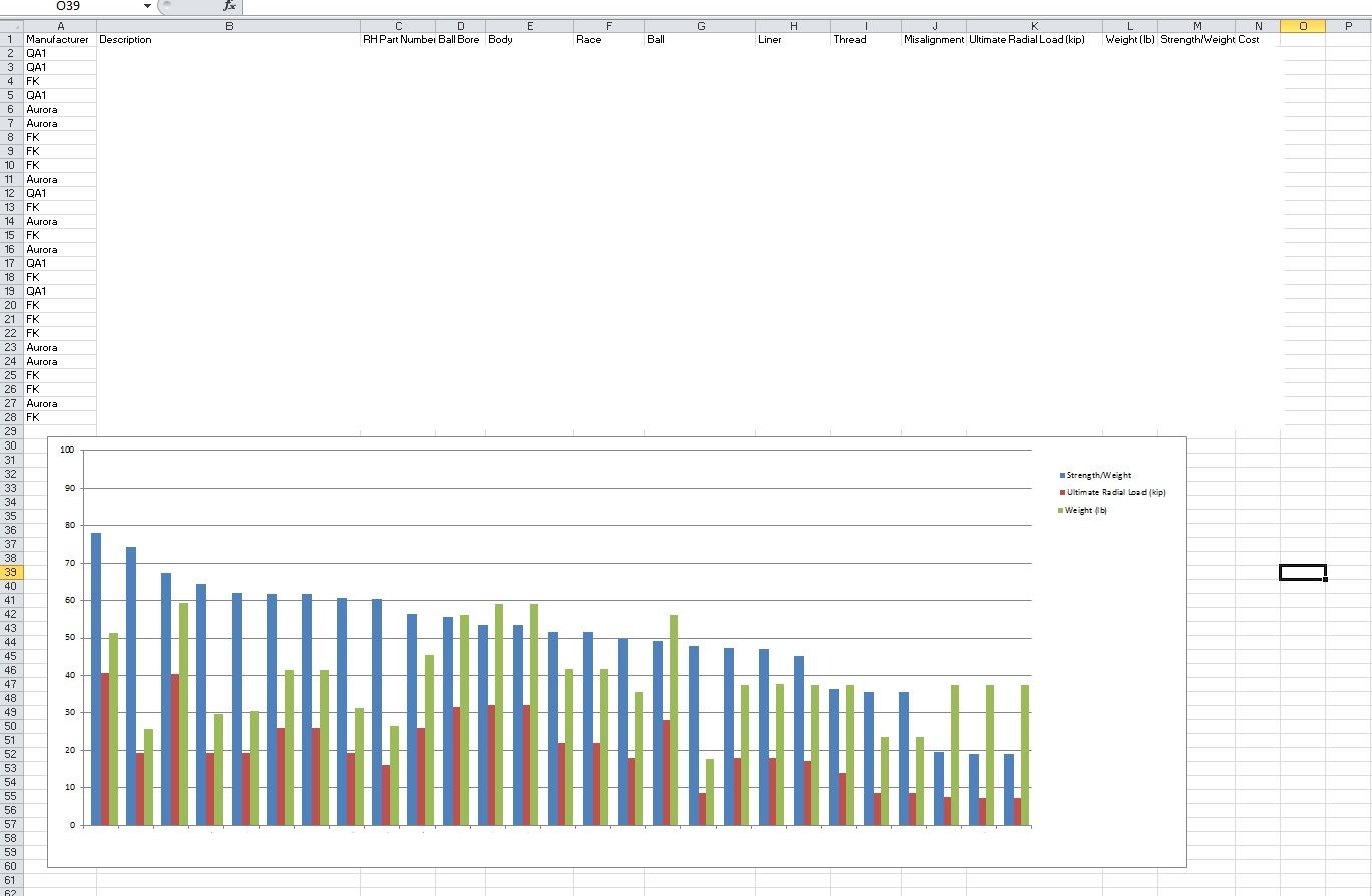

With that settled we went about selecting the appropriate rod end. To do this we directly compared various rod ends available. We also had to consider the possibility of galvanic corrosion if we mated a steel rod end into an aluminum turnbuckle. We considered threaded inserts into the turnbuckle, but we were able to find a suitable aluminum rod end
(Information intentionally omitted because China and copycats can do its own research)

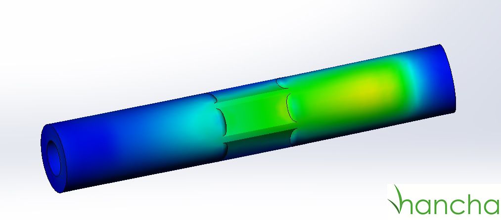

The most difficult and nerve wracking part was designing the shank. People discuss whether the taper is necessary or not, and if you are using a suitable material that can handle the added stress and has enough fatigue resistance, then you can indeed get rid of the taper. However, there will be more displacement because there is no longer the cast iron knuckle pushing back against it. We decided to keep the taper. Since the design envelope is the same as the OEM piece, we went with a high-strength stainless steel for the shank material. The alloy is about twice as strong as 4130 with the added benefit of corrosion resistance. Luckily there was no need to FEA here since the design is the same, but with a much stronger steel.

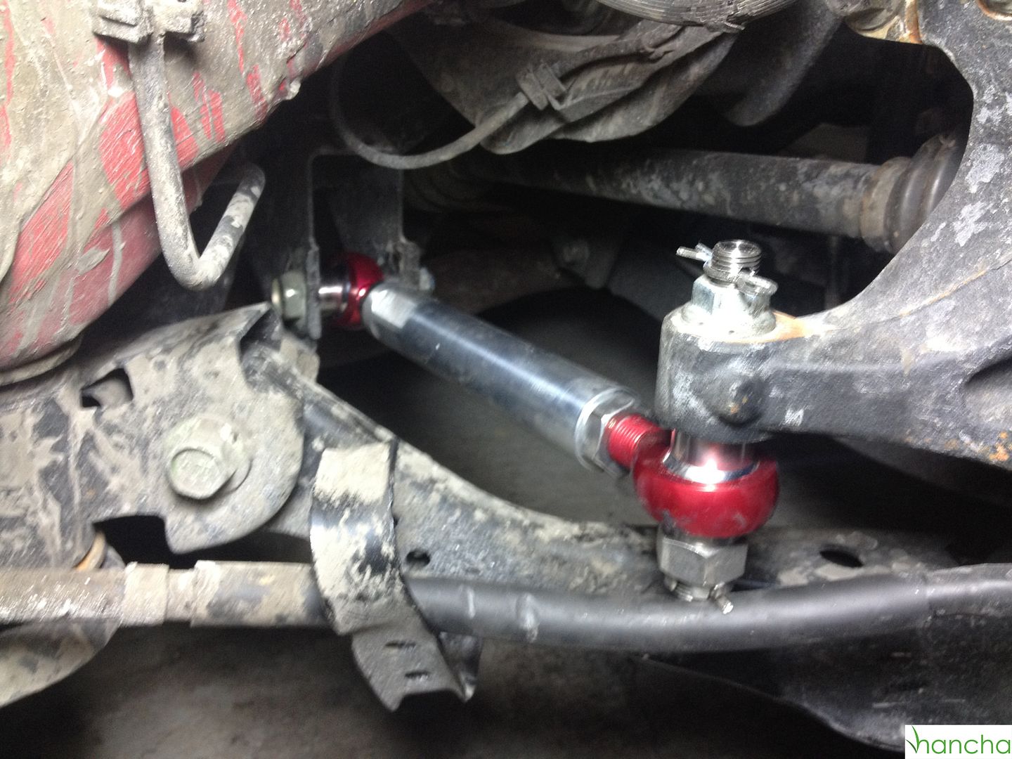

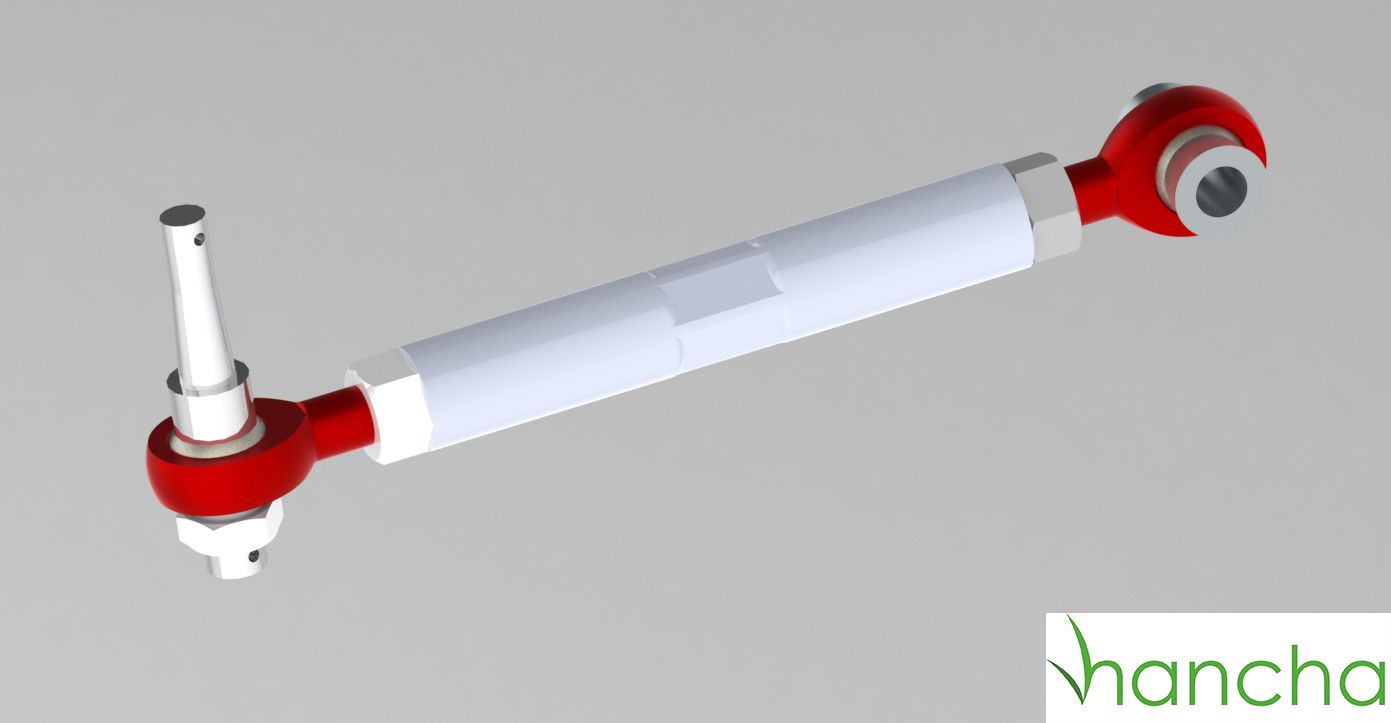

We got the prototype back and here's a side-by-side comparison of the OEM link and our link
Installed on the car
The only issue we ran into was that because we used a castle nut on the bottom of the shank, it was too long and touched the e-brake cable. Our production version will use a stainless-nylon lock nut allowing us to shorten it by 10mm. A rendering of what the final production version will look like

I your blog you mention going for stiffness to weight as a priority. But then you chose aluminum over chrome-moly. Why, when aluminium has much lower E modulus? (It's hard to see how much of a diameter change on your part vs stock.)
Also, why bother with a nonstandard aluminum alloy (26xx?) when the rod-ends are 7075?

On the first point, aluminum can be made larger in diameter and higher in thickness while maintaining similar weight as a chromoly part. This allows for a stiffer part at the same weight that is going to be less fragile.
Aluminum bicycle frames can be punishingly stiff due to the large diameter tubes used. Steel frames can be made just as light, but the superlight steel frames are prone to damage as the wall thickness is so low. This is also problematic for mounting of hardware.
Stiffness for a composite part such as this is a combination of the entire system's stiffness. There are still gains to be made by stiffening the bulk of the material even if the rod ends have some flex. The rod end composes such a short part of the total length that I could see stiffness benefits overall happening choosing a stiffer alloy for the rest.

I understand the shape/size aspect to stiffness, but in the side by side with the original steel part there looks like very minimal diameter increase.

Considering I got the opportunity of being the first test mule for these toe links I thought in addition to giving the guys at Hancha feedback on the part I might as well share my thoughts/experiences so far with everyone on here.
The fit and finish on these things is fantastic. As much as I'm not the type of guy that's all about things being made in US, I like knowing that these toe arms were designed and made in the US and to a very high standard. The link is much beefier than your typical toe arms (about the thickness of the axles), which is confidence inspiring considering my cars typically take a beating.
I haven't gotten an actual alignment yet as I'm waiting to pick up rear control arms next week, so for now a good eyeballed alignment will have to do. Adjustment was easy and straightforward, and the rod ends thread way into the rod so they have A LOT of adjustment in them.
I'll be sure to report back after I take the car to the track, but so far I've just been commuting and doing a little hard driving on the street, and the car feels great.
