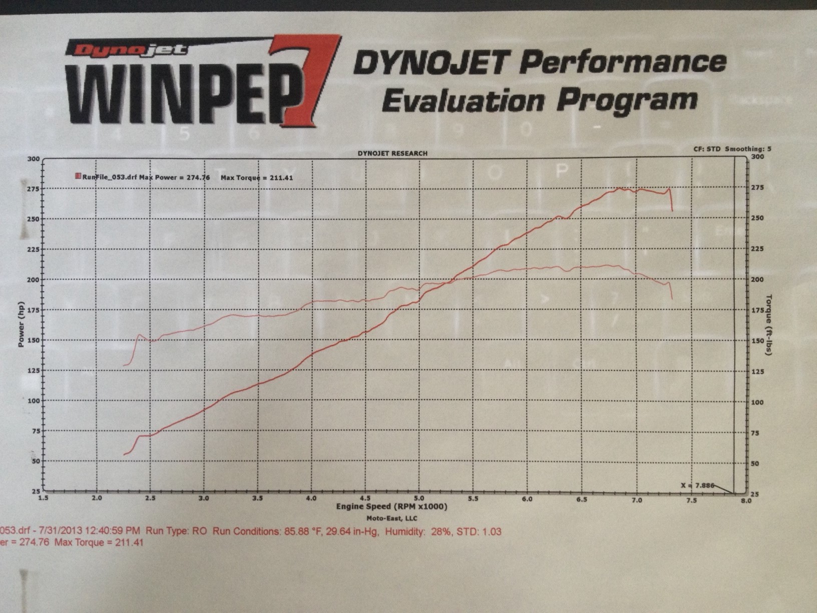

It's been a while and @Adeets stopped in to get it retuned with the bigger injectors. We tweaked the fuel ratios, timing, and cam phasing to pickup a bunch of hp top and bottom....note the now smooth curve on pump. Looks like we have some more room to go still, but we held back as a smaller pulley will be going on soon.
Sorry for the crappy paper, we have a totally different car on the dyno and don't want to screw up the screen there.

Let me make sure I am understanding you correctly. The reason that Adeets hits 275HP and everyone else flatlines at 255HP with the same mods is because Adeets has upgraded port fuel injectors? That's it?

I don't know what the other guys are doing with those tunes. We ran adeets' car on the stock injectors and with a mild overdrive of the DI ran into IPW issues at the top end. Using bigger injectors allowed us to run much shorter pulsewidths. With that said, we've learned a good bit before dyno session 1 and 2, so there are other tweaks in there. Yes, you can achieve good numbers on the stock port injectors, but IMO there are too many compromises compared to just forking over the 300 and then having the headroom.

Thanks for the response! I read through 50+ pages of Vortech threads today, and adeet's dyno is the only one I've seen that keeps HP climbing past 6k RPM and doesn't level out.
I'm no expert, had to google what IPW means, but I was trying to figure out if I should be impressed or skeptical
It's clear from your first posted dyno that you've made great strides in tuning this thing. Do you have any other stock pulley/pump gas Vortech dynos on the forum that I could look at for comparison? It's so hard to find good dynos...
