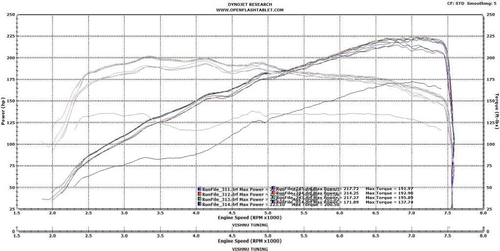

Shiv just posted his dyno of the new Phantom 250, 1.5 dump, OFH E85 tune: no other mods, even stock air filter. I wanted to do an overlay, but I haven't seen a dyno for the ESC 1.5 with Shiv's new 91 or 93 tune, so I grabbed his last dyno which was the Phantom 250, 2.0 dump with mods:
OpenFlash Tablet
OpenFlash Header
Single tip cat-back
Modified air duct
93oct (although the it's mapped conservatively enough to make the same power on 91oct)
[Stock run shown for reference]
It's kind of hard to make out, but the E85 runs are the ones making moar powa.
that bottom end just keeps getting stronger.

Looks great! I'm also excited for E85 performance when not on boost. I find one of my favorite things about this ESC is the ability to still drive my car like normal all the way to redline due to where I've set my throttle switch (at like, 95%). E85 is going to be a solid power improvement in situations where I'm not boosting too -- maybe even more so than boost conditions.
strangely enough, I didn't even think about that. I guess I'll have to wait till someone else logs some dyno time, and does an ESC off, e85 run.

Eh, it'll definitely be a solid improvement. Not sure what you would wait for -- if you have access to and are comfortable using E85 I'd just do it. I'm just saying that I'm excited for off boost performance too, as I was running E85 NA before I bought the ESC and loved it going back to 91 hurt a little.
