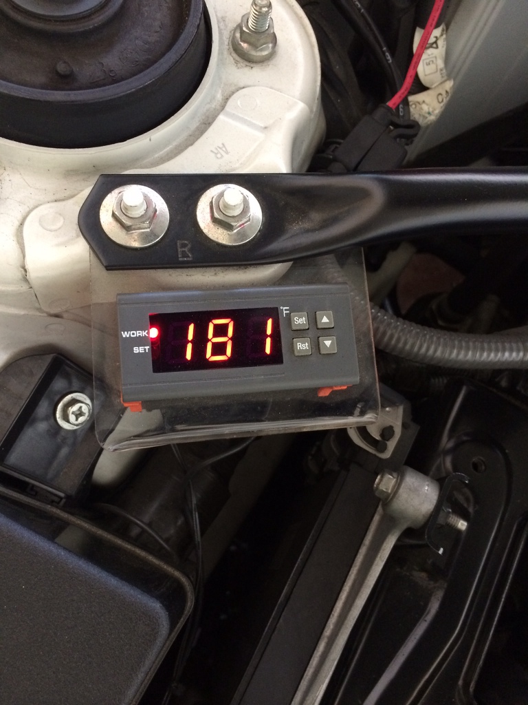

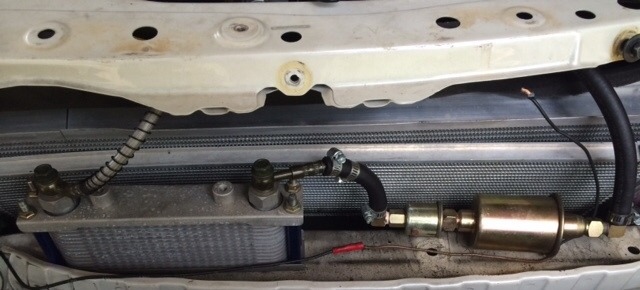

Hi
I have the vortech SC, no heat issue here, but use 20 rows oil cooler (for the engine), koyo rad, and SC oil cooler. Last fun run was 2hrs of back roads on each direction, from sea level to almost 4000ft on several ups and down. Speed 25-35 so no much air flow and temps:
Engine avg 210f, max 222f
Coolant avg 200f, max 210f
Intake avg 115f, max 125f
SC oil temp max 181f
So as you can see centrifugal SC is kind of easy to control heat, but it run with much less torq than turbo...
Looking at the 335 SC that Moto mike is having so much fun with it. But really want to see how it performs on summer at the track (if I use that set up it will have WMI).
Size:  79.3 KB SC oil cooler with oil pump and inline filter.

Size:  250.1 KB SC oil pump controller (the brain of the SC)
