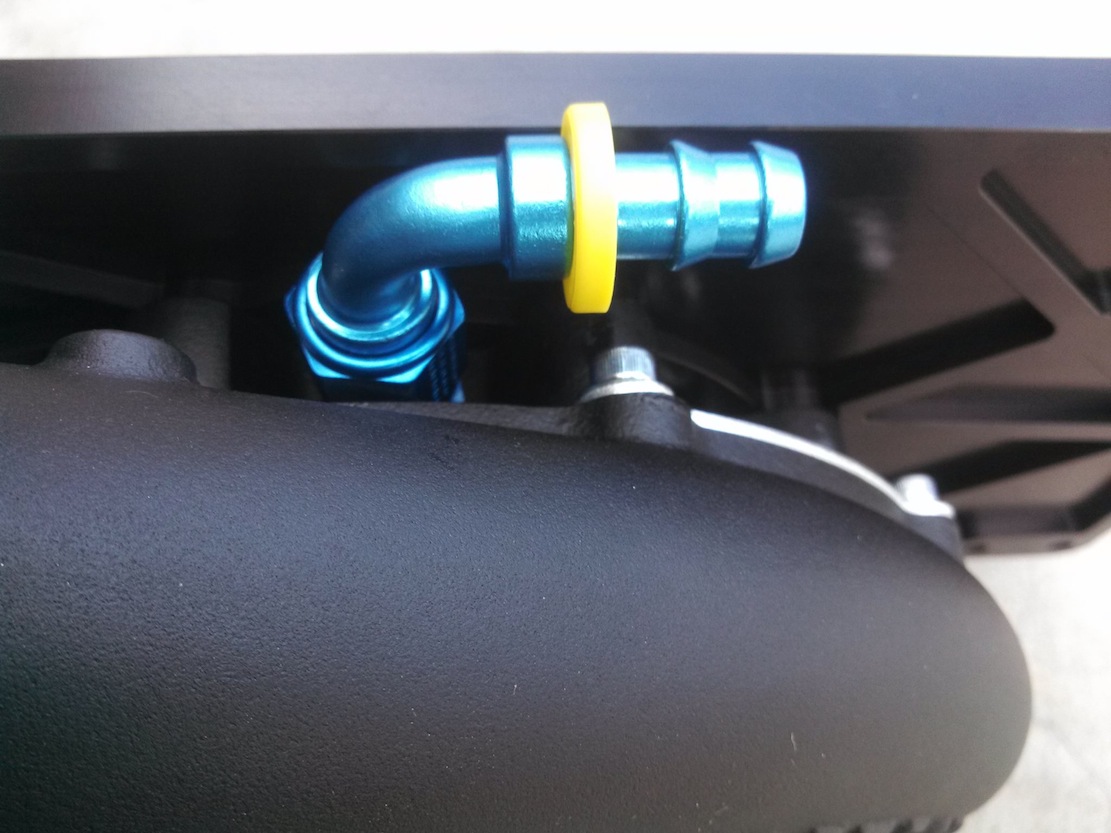

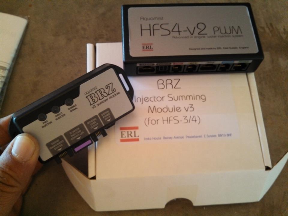

Injection summing isnt maf based!

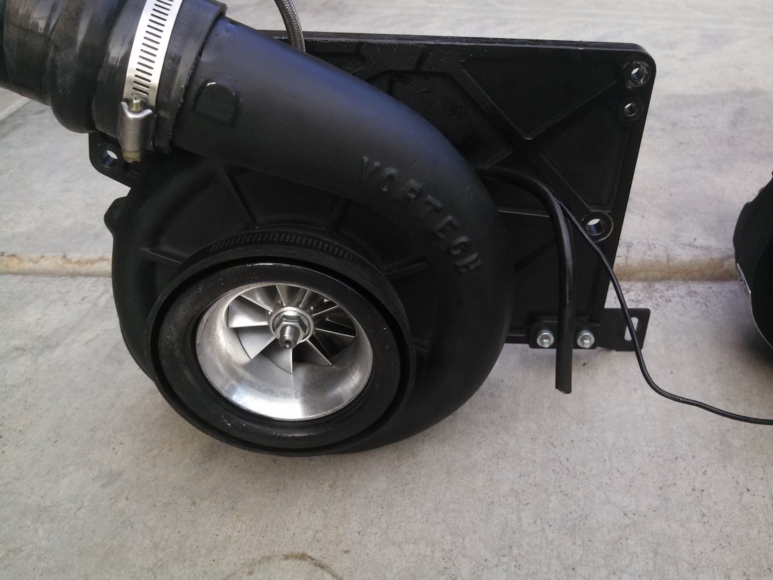

Here is the new dimpled cast pipe!

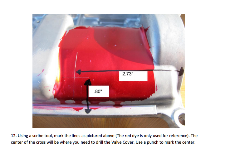

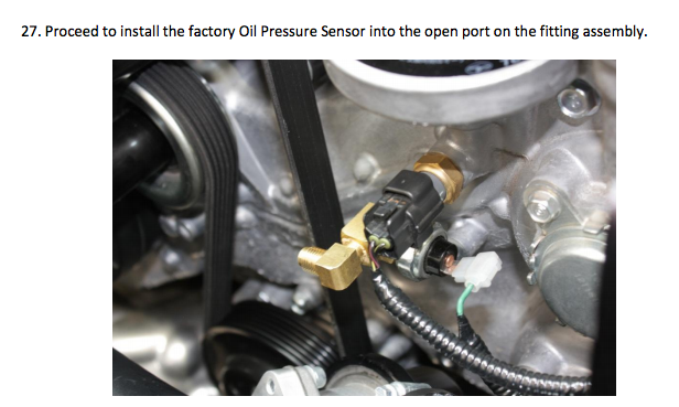

rest of the pics are of the new oil fed vortech kit, I have gotten some PMs asking for pics so here they are @Adeets
The new compressor boasts 20% more peak spin speed, while I wont be using the headroom, it makes for a cooler running sc and one thats able to be run at redline longer, so here are some old vs new pics
