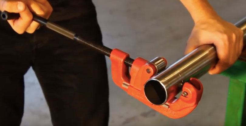

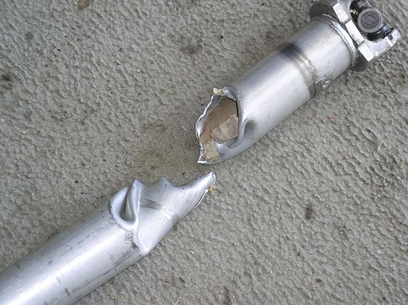

It's just a suspiciously clean break. I would expect something more like this.
Now that is a failure from more torque than the drive shaft was designed for.

Yes, I know. I was posting more to show how aluminum usually bends and rips, not a perfect cut like a pipe cutter.
