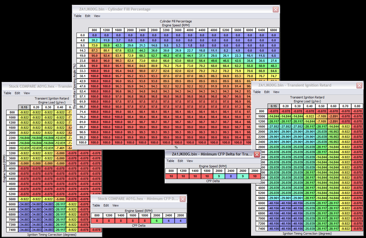

There are 3 tables that play together with transient ignition timing retard. It's active all the time and not just high rpm shifts.
Subaru changed the strategy with MY17. The large table "Cylinder fill percentage" is the same for both MY13 and 17.
If we take an example, 2400 rpm and you drive with 5% throttle and increase the throttle to 10%, it's a difference (or delta) of 21.3 to the cylinder fill percentage.
For the MY13 a delta of "4" is required to activate transient ignition timing (small table left) and it will take out timing according to the load. E.g. load 0.30 and 2400 rpm = -14.844 deg timing.
For the MY13 a delta of "8" is required to activate transient ignition timing (small table right) and it will take out timing according to the load. E.g. load 0.30 and 2400 rpm = -29.661 deg timing.
Obviously, this is an extreme example and the result is the same as the delta is so high. But imagine you drive with 7.9% throttle and increase it to 9.4% (made up numbers didn't check what that would result in). But you get the idea, one table with just 4 minimum CFP delta might activate where with 10 it won't.
So the new strategy is for it to activate at a higher delta, but then take out significantly more timing.
If you use the new transient table with the old Minimum CFP delta table, you will have bucking, especially around 2400 rpm and low throttle (causal) driving.
If it takes out too much timing, it will have the same effect as hitting the soft rev limiter (works the same by taking out a lot of timing). It will feel like misfires and you get the bucking. It's not just a hypothesis, this is logged and tested on several cars that had bucking issue due to mismatch of those tables.
Here an example of bad bucking which went away after using the new Minimum CFP delta. Ignition timing drops from 30 down to about 8 deg a couple of times. Of course, it gets more complicated than just reading straight down the tables as we did in the examples above as load is going to jump around too:
Obviously, I can't say if this is your issue but it's worth looking into. The example and tables above is manual transmission. I don't have a K01I ROM and I don't have that much experience with automatics, so your issue could be something different.
I have the tables on the right and it is taking a lot of timing. What are the impacts of increasing the min CFP delta table entries so that it doesn't do it as much?

I described it in the previous post. If you increase the CFP delta is doesn't take out a lot of timing for small throttle changes where it isn't necessary.
I'm not sure it's your issue though, as I would be surprised if your tune doesn't already have the MY17 CFP delta table... given that it has the MY17 transient retard.
