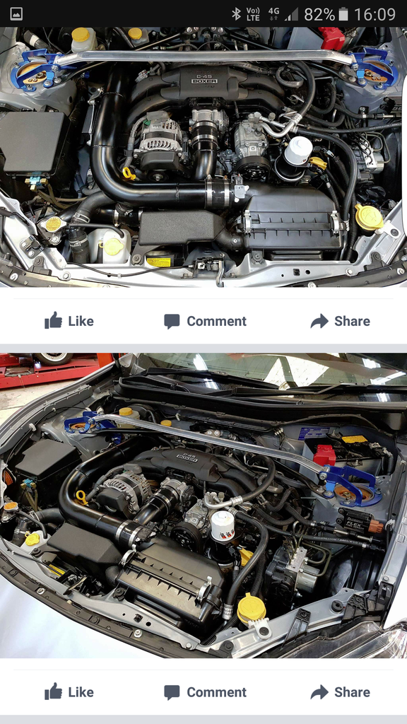

I'm not sure where you are looking but there are many options for RHD turbo. Literally everything except the ptuning kit will fit.
Here is a company from Australia that sells a kit which looks almost identical to ptuning.

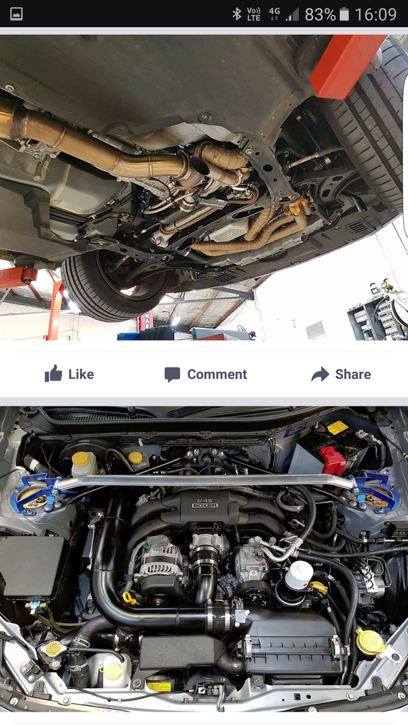

Have a look at sydney motorsport engineering on Facebook. Most aussies use their turbo kits. They offer a race and road spec option and can make single and twin scroll manifolds.
There is also a kit made by coyoda. However there isn't much info on Google about this kit

thats a neat looking kit, just the remote wastegate exit that needs sorting so its not exiting under the car and gassing the occupants out in traffic
however a GTx30 is a very large turbo for a 2.0 ltr engine and road use as it won't spool up until 3500rpm or so as I don't think its the twin scroll option
however I have yet to see anyone trying the anti-lag option thats available with these cars.........
