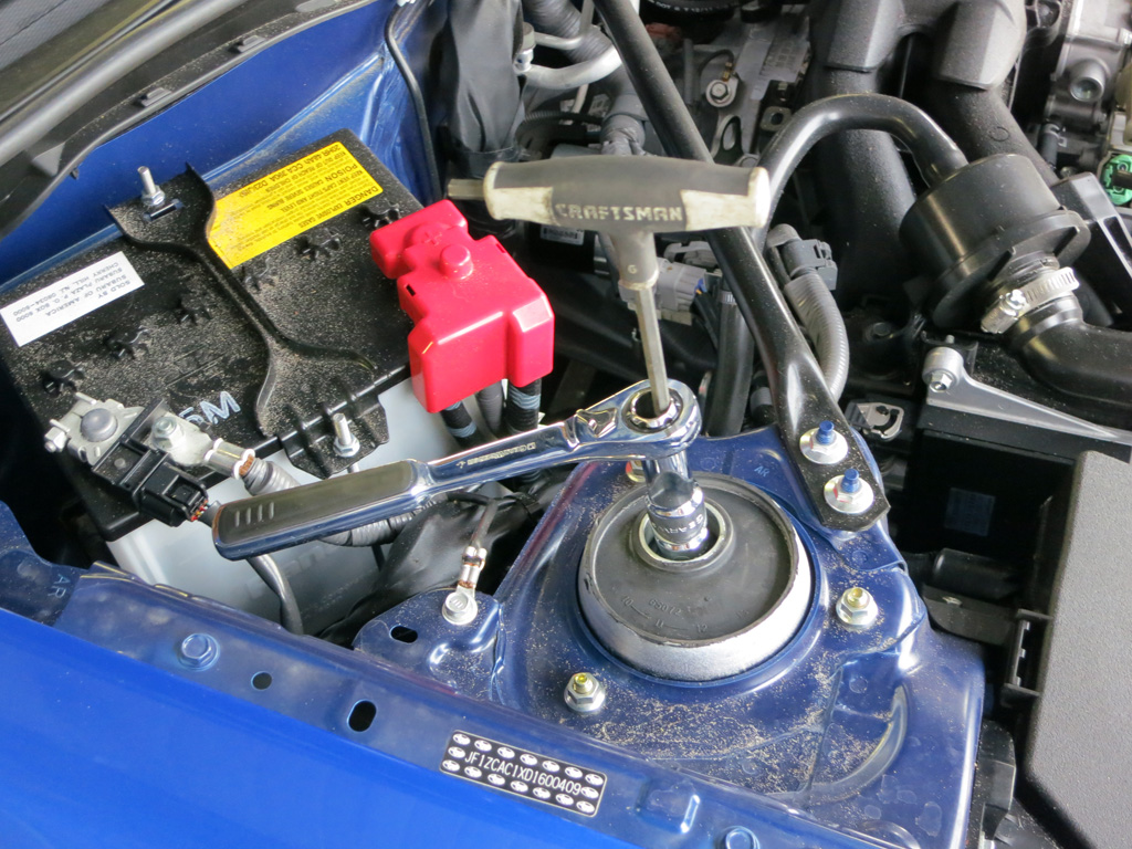

Pics of two "proper" tools for top hat shaft nut removal will be posted in here soon. Darren can incorporate in his initial thread as needed/desired.

There was a thread in the suspension section about a guy that ruined his shocks by tightening the top nut down with an impact wrench. Apparently you are suppose to support the strut somehow to keep it from turning to avoid damaging the seals. How did you handle this with your install?
http://www.ft86club.com/forums/showthread.php?t=14599
That's what I'll post pics of soon. I used two different tools (well I really just used one but took pics of two). One was provided by Tony Jackson @ Eibach who was at an event I run and that Eibach was a Sponsor of, and the other is a simple pass thru ratchet.

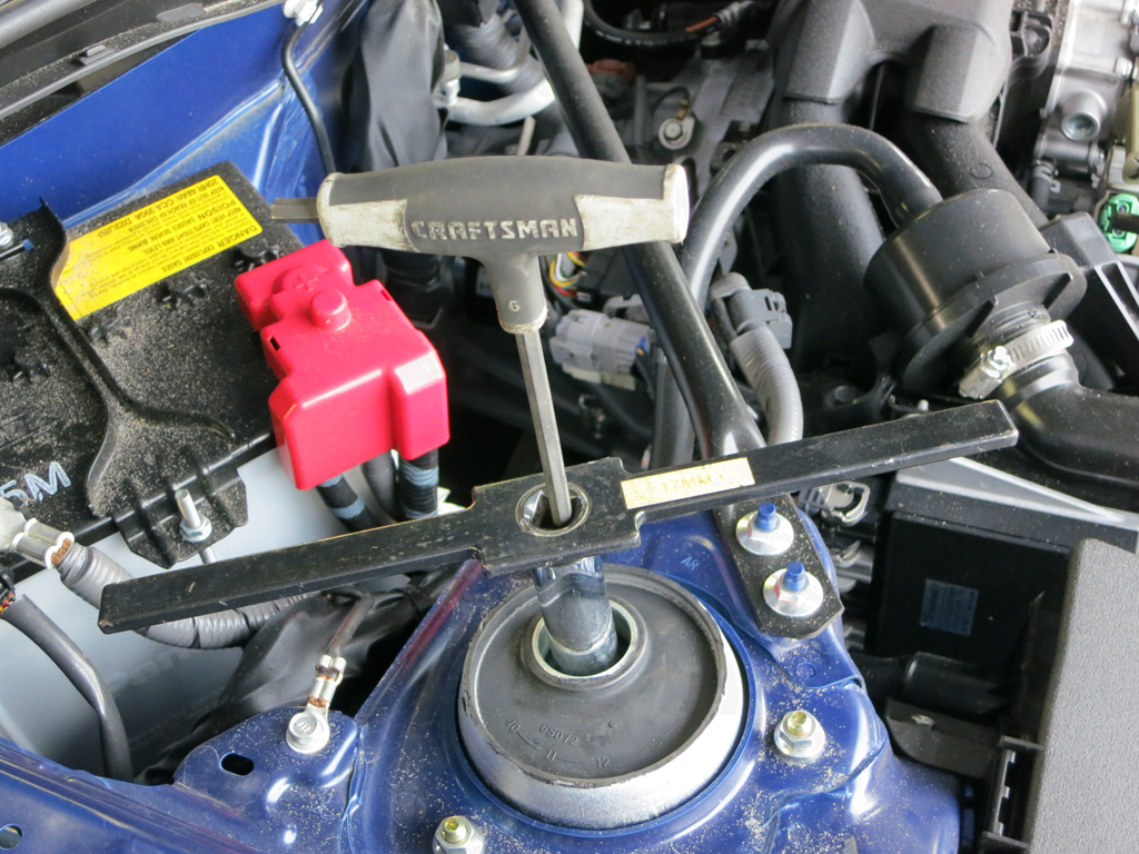

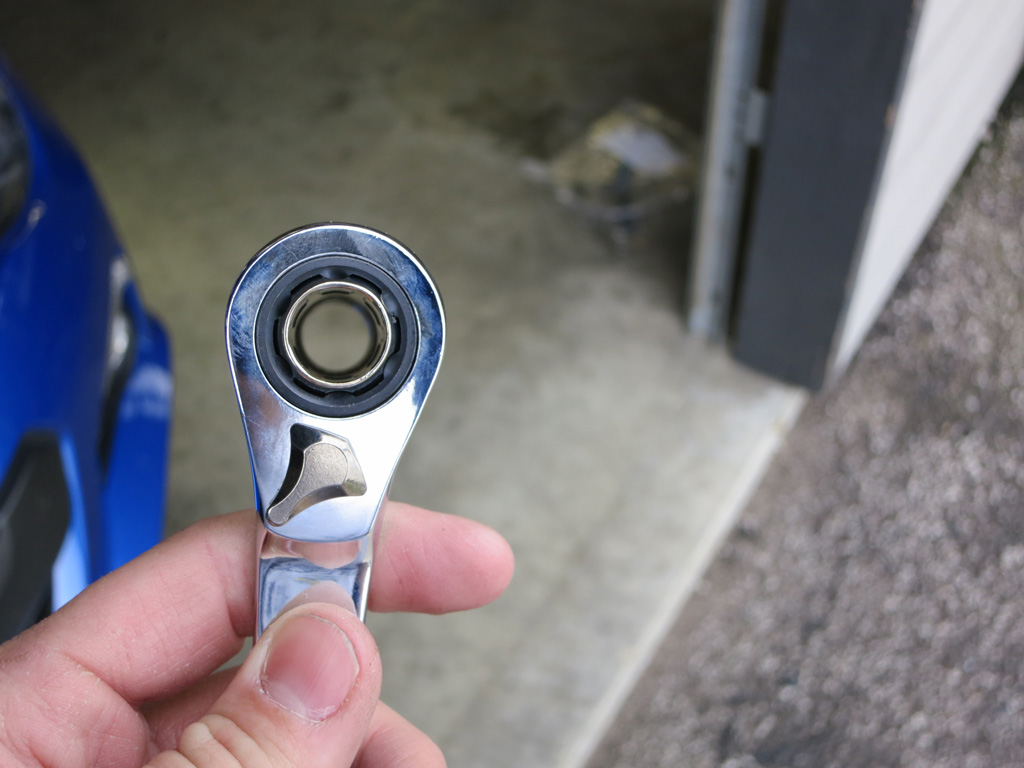

Pics of the proper tools. Note, these both require spring compressors to be safe and I took these pics after the spring swap (was in a hurry to do the springs between the end of track sessions and our event banquet), normally you wouldn't use them on the car except to break the bolt loose.
First, the tool brought by Eibach. Not sure where you would find this one but you could make it (weld 3/8" or 1/2" drive socket to a steel bar):
Second, the GearRatchet made by Gearwrench:
And looking through the hole in the middle of the gearratchet setup:
-Dave
This plus the spring compressor are priceless tools for this install.

so it's safe to use an impact to remove the top nut from the strut, just as long as you don't use an impact when replacing the nut during reassembly, correct?

It's not that tight to use an impact. Just secure the center shaft with an Allen key and a curved box wrench... Might have to modify the wrench to get in there... Make sure the shock has the spring compressors on.
