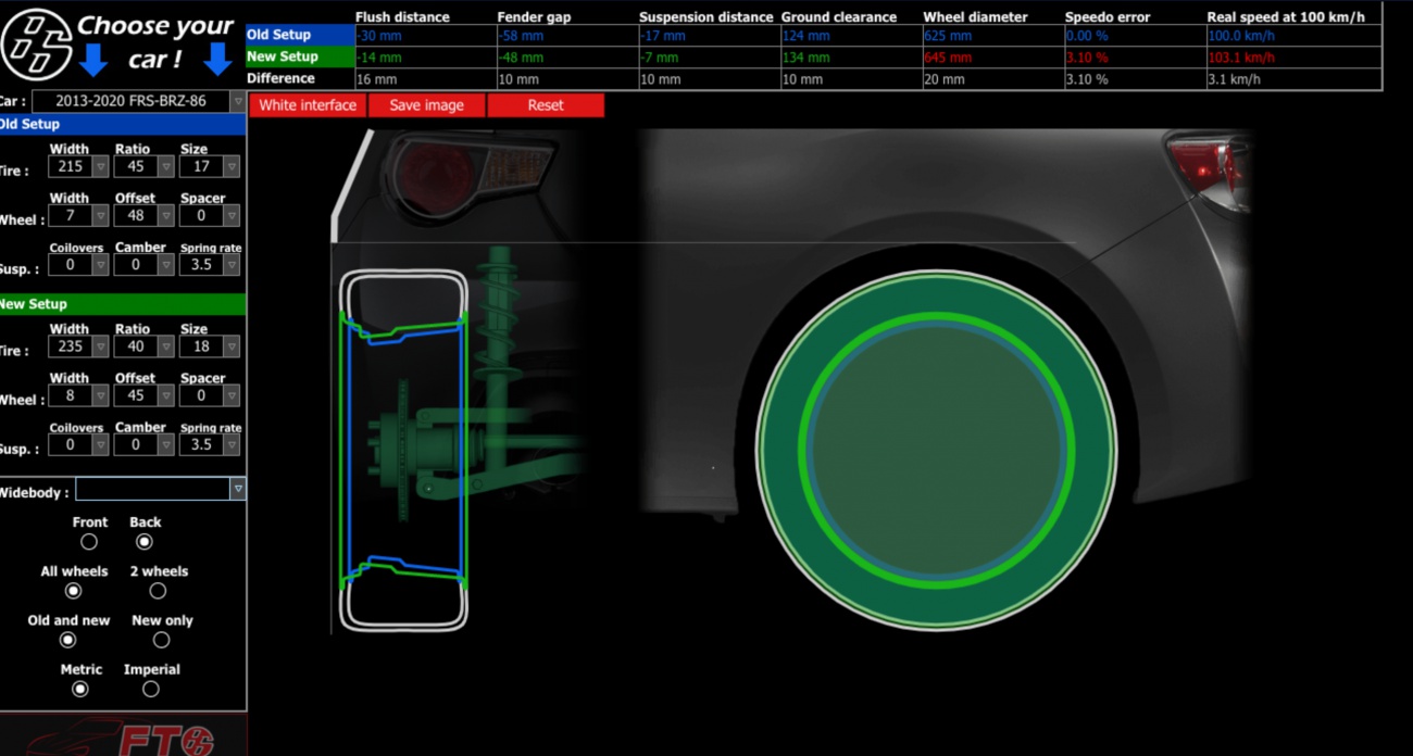

Stock Suspension fitment for 18x8 +45 offset
Hey all Im planning on buying a set of wheels for my BRZ with stock suspension. The wheels themselves are 18x8 with +45 offset. I am concerned about tire fitment and rubbing on stock suspension. I believe a 235 40 18r tire would fit with these wheels and my stock suspension but I would like to know if anyone is running this or a similar set up on their stock ft86.
I have also attached the wheel fitment from wheel it fit, I appreciate any help I can get from the community!
jasson is offline   Reply With Quote
Theres not going to be rubbing anywhere whatsoever that wheel spec is pretty conservative. One thing to note is your tire choice is a pretty tall tire compared to stock specs, i would suggest using a 225/40/18.
