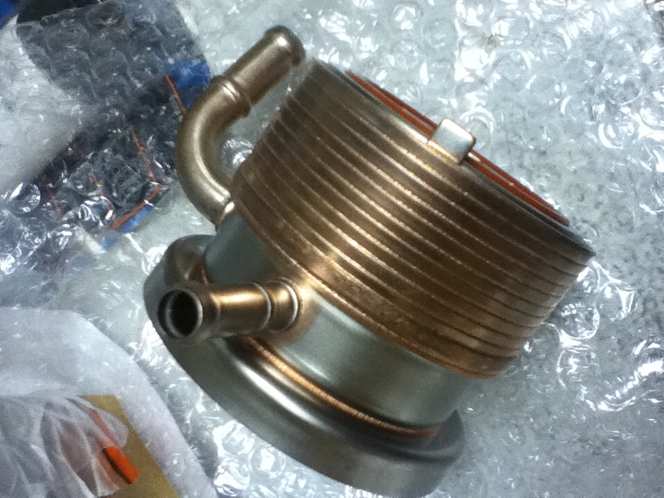

Did your oil cooler have this on it?
Did your plate have this nub on it? Did you remove it or leave it on?

That's the bitch that caused the issue. It has to fit into the groove. Mine was half in half out Sent from my iPhone using Tapatalk |
