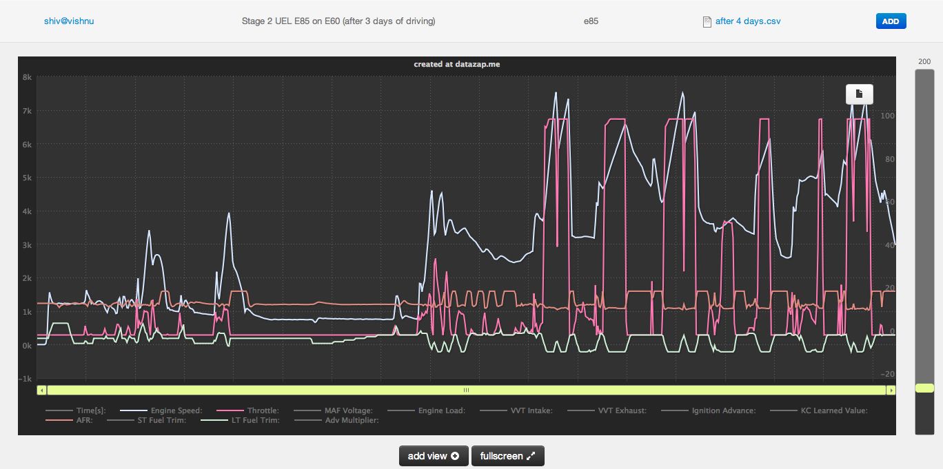

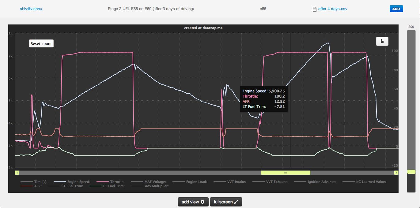

Quick update:
Took a datalog today on the way back to the office from Chipotle. After 3 more days (~200 miles) of driving on E60, you can see that no additional LTFT has been done. In other words, all the learning that the ECU did in the last 200 miles of running E60 (instead of E85) was done within the first few miles after leaving the gas station. And at no time (even during that first WOT run before learning) did the car feel "out of tune". It hasn't felt anything less than perfect since adding gasoline to my E85 tank.
Still goes to show that it's not necessary to be concerned about ethanol % variance in E85. The ECU will handle things effectively and quickly. And without the having to add any more hardware (flexfuel sensor kit) or custom code.
Link to log:
http://datazap.me/u/shivvishnu/stage...3-days-driving
Full log:
Partial log:

Quick update:
It's worth noting though, that lowering your ethanol % will improve fuel mileage. So if the car is getting all the knock protection it needs, and running the most timing it can with only around 100 octane requirements, then is there any reason you couldn't regularly run a 65/35 mix of e85/91? Assuming e10 gas, that gives you e58 and an effective octane of 100 even.
In "theory" you'd get a 12.5% improvement in fuel mileage over straight e85.

Originally Posted by RickyB View Post
I thought the whole reason for flex fuel was to make it easy to pull up to any pump and fill the tank with whatever was available without having to switch between a gasoline vs. an E85 map.
That is correct. But the purpose of this thread was in response to those who are now claiming that a flexfuel kit was necessary for those running exclusively on E85 due to the ethanol content variance that is typical from station to station and from season to season. The point of this thread was not to suggest that a static non-flexfuel tune can handle flexfuel duties. But rather that a static non-flexfuel tune can indeed handle even the widest reasonable ethanol variance found in pump E85

The proof is in the logs. I myself really wanted a full flex fuel setup, but the more I have seen the e85 tune being run from various members (with various setups, ethanol content, and temperatures), the more I am convinced a quality tune is all that is needed.
