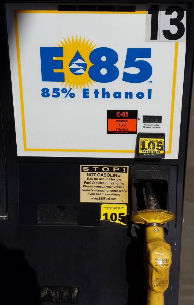

Is this a country wide issue as the pump I fill up at states a minimum of 70% of ethanol? I haven't personally tested the ethanol content but based off the LTFT's my car is running and the cold starting issues with a straight E85 tune I'm guessing the ethanol content is actually higher than 85%.
Obviously a true flexfuel setup is ideal and that is one of the nice things that ECUtek has going for it right now.

Is this country wide as the pump I fill at states a minimum of 70% of ethanol? I haven't personally tested the ethanol content but based off the LTFT's my car is running and the cold starting issues with a straight E85 tune I'm guessing the ethanol content is actually higher than E85.
I read this earlier
http://ethanolproducer.com/articles/...-to-51-percent
Maybe the sticker on the pump is old?
I would get an ethanol content tester regardless, it never hurts to know how much

i've found that the local content has gone from around 78% down to around 73% in the time i've been running e85. i haven't had to make any adjustments for it, fuel trims just average up or down a bit depending on the blend.
