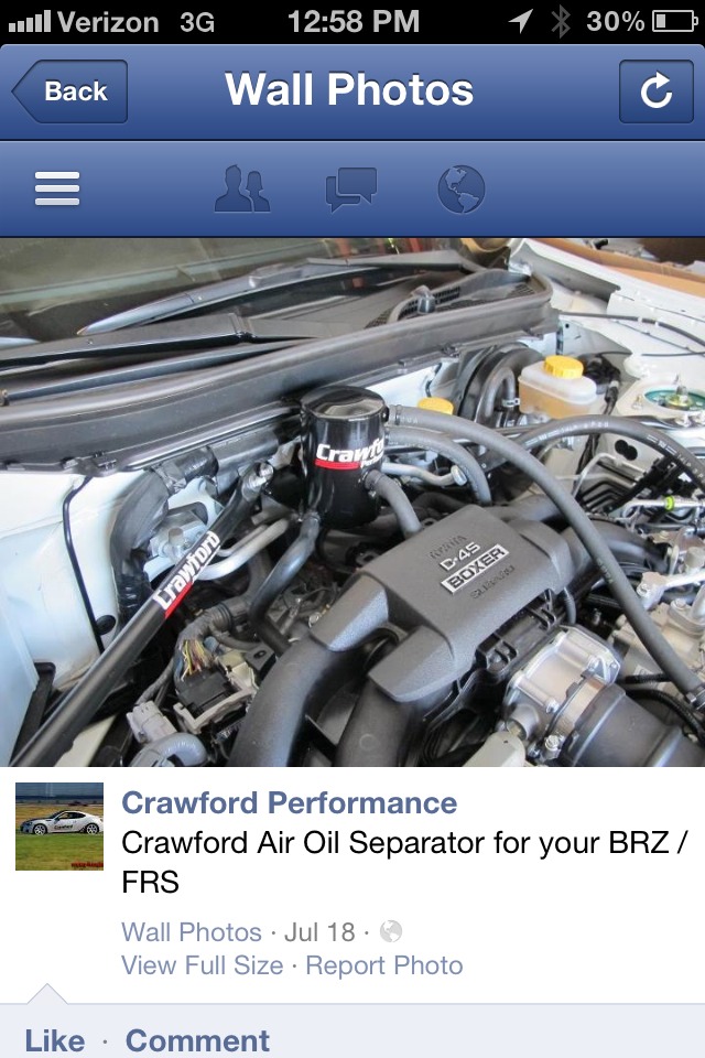

Originally Posted by Memphis View Post
Is there a place to get a Crawford one?
Crawford will have them...
I'll also carry them because they're badass

Old 09-04-2012, 03:47 PM   #35
Jamifra
Jamifra's Avatar
Drives: 2013 Civic Si
Location: PR
Posts: 111
Thanks: 59
Thanked 57 Times in 20 Posts
Attachment 14435
they are really badass pieces but i think $300+ for a oil catch can is a little to much when you can have pieces with the same quality and do the same work for a lot less...my 2 cents.
