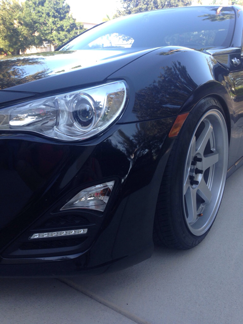

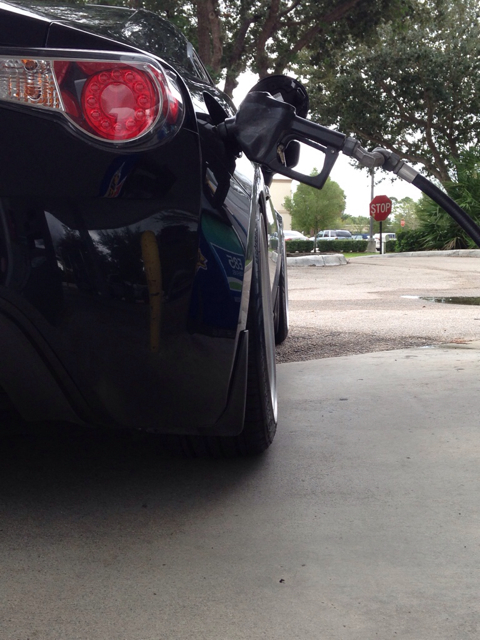

Originally Posted by AlexWood View Post
I think 225 front and 245 rear would work. This is about 2-2.5in drop with 18x9.5 +34 with 235/40 tires square Attachment 105293Attachment 105294
They fit with no fender mods and very little rubbing.
