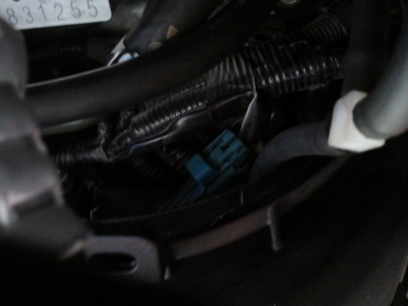

Originally Posted by Ross View Post
Also double check your evap solenoid vacuum hose at the manifold. I have found a leak there as well as no clamp is used on it.
where is this line located on the intake manifold? i definitely need to check mine. thanks for the heads up!
Below the manifold towards the driver. You will see a blue connector, its hard to see, the solenoid is literally below the intake manifold. If you haven't gone to crazy PS numbers, (like 14+) most probably its ok. But you would also notice some kind of symptom of vacuum leak.

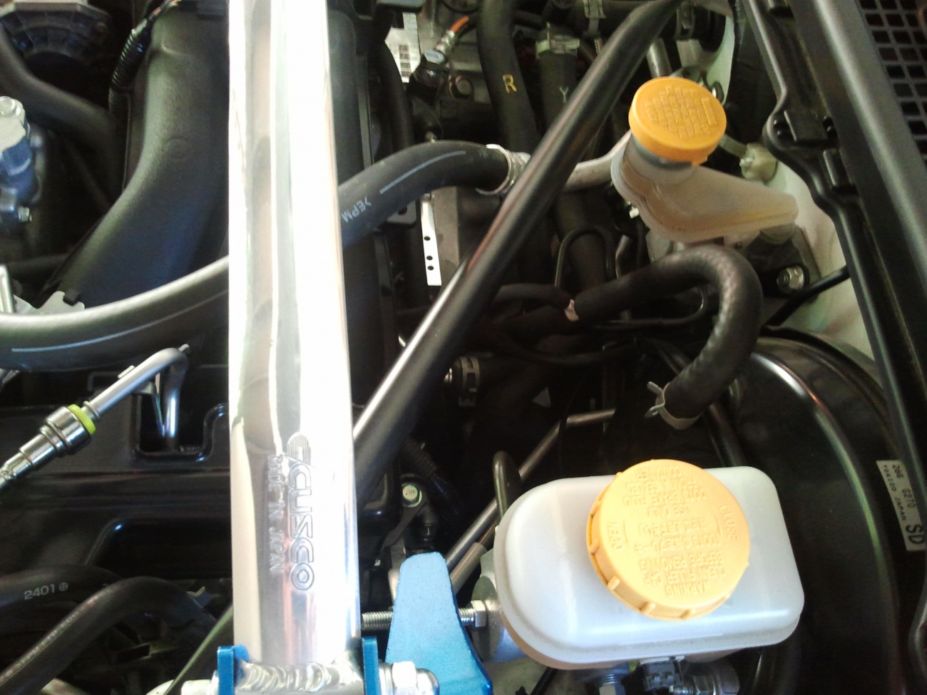

Well I think James won't be able to post but his picture showing the check valve installation isn't visible. Can anyone post it or similar? Thanks.
