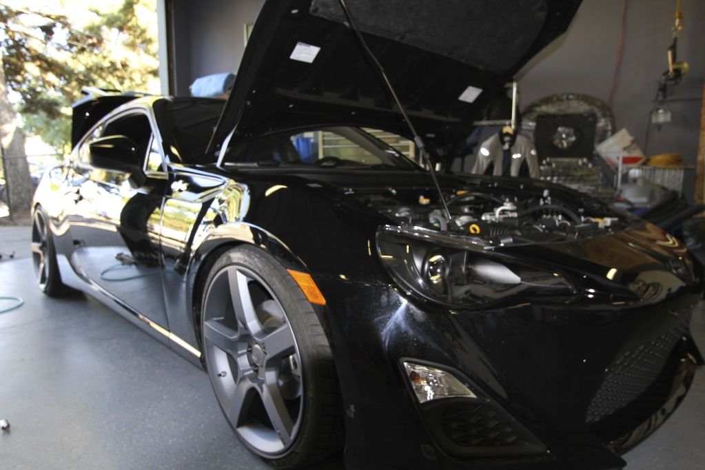

current Setup/look as of last weekend..

not sure... I don't think they were at any particular height... Basically I counted threads... I remember going up on the rears quite a bit..like 15 threads.. the front I went up just a bit.. I am a firm believer of parallel arms and other components.. so I adjusted to achieve that.. then fine tuned the rake and alignment...
ALIGNMENT is critical on these cars.. they are very sensitive to the correct attitude on the alignment... to little..they skate all over the place.. to much..they won't turn that well..
Bill
