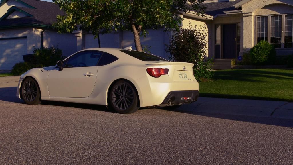

I'm lowered on BC coilovers, not positive on the dimensions unfortunately.(Picture for drop reference) I want to buy RPF1's in 18x9.5 +38, tires 245/35/18. I don't want my alignment specs to be super far off but I also don't want to be destroying tires or fenders. Will I need toe arms and LCA's? I can get them through a vendor here in town, just not sure if they are necessary or not.
SASKYSASKATCHEWAN SK86BRZ / TB BUILD THREAD MY BUILD
