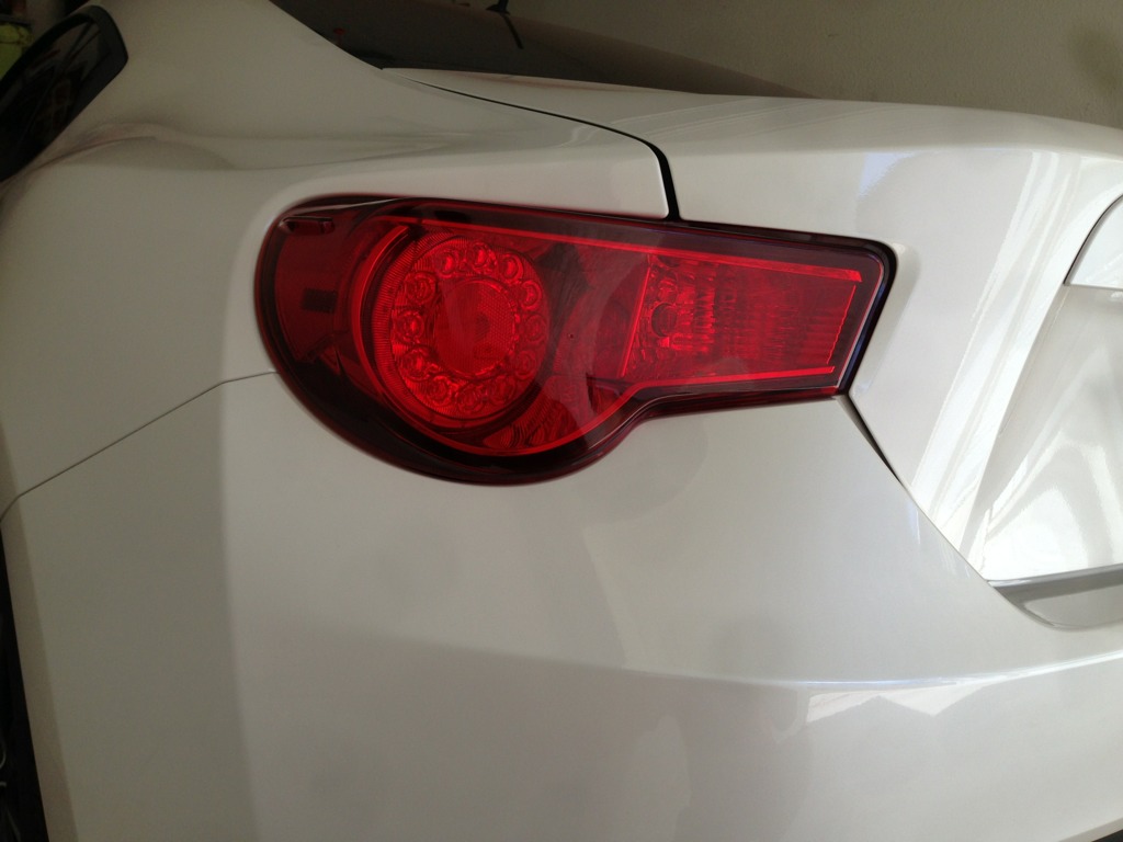

Mine (sorry that they are attachments)
Attachment 37466
Attachment 37548
Attachment 37549
Duplicolor Metal Cast and professional clear

Yes, 2000 is good. Make it look foggy and spray.
My paint shop color sanded mine when all was said and done

The 2000 is to get the paint to stick. Just prep. You are sanding the clear lights until they look a little foggy. Make sure it is uniform and all over (even edges), then spray. The final product will be clear. When the color is done take it to a body shop. In all honesty you won't even have to color sand for it to look good (or at least mine didn't really need to be) but my shop did it anyway.

Sorry, just saw this guys. I paid $80, but he burned through the paint sanding, re-did it and once again, he burned through the paint. I offered to pay him another $60 because I could tell he was getting annoyed. This time, he let me do 100% of it at his shop and helped me as well as didn't need to sand because the paint was all fresh. I had to sand most of the old clear and red off and start over again. It was worth every penny and was still cheaper than TOM's (Only other lights I would consider)
You can probably talk a shop into doing it for around $100....Just make sure they don't sand the paint. There are so many sharp edges, it is super easy to burn through even sanding lightly.

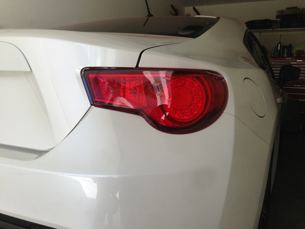

Originally Posted by Scooby South View Post
and with the lights on..
Dont know if its me, but your tail lights look unevenly taped off.. kind of sticks out in pictures
I think its the angle I took the pics.. trust me.. they 'are' even...
