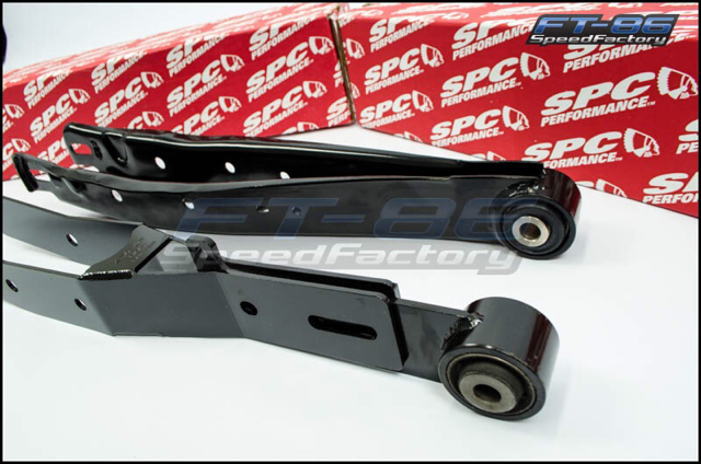

One question is - what SPC LCA was on Asabos car? Same as this below?
Attachment 81914
Aasbo is running the new version SPC LCA for the FRS/BRZ Here. The image your post had both old and new version. I run the new SPC LCA and think they are good for the street, but I totally agree with CSG Mike and think that the SPL stuff is the best stuff out there.

Nonetheless, it is very impressive that SPC LCA is able to match with Asobo driving for the entire season, this says a lot.
