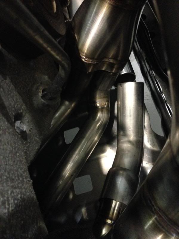

Today was wastegate recirc day, I hate doing these. Nothing like taking a down pipe you spent a while making and carving a huge hole in the side of it. For this one I'm playing with a new quasi bell mouth shape. Fitment is a bit looser then I normal like but since its the first I'll roll with it.
This is a 3" down pipe that tapers to 2.5" I've decided I will find out what I can do with a 2.5" exhaust since I believe most people can hit there power goals with out a 3".

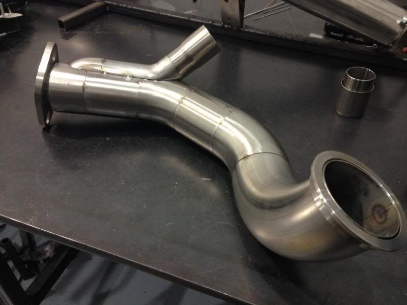

Little TIG action on the 3" V-Band adapter for the down pipe.

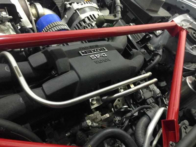

Finished up the crankcase hardlines, small mount tabs bolt onto the tabs on the rear of the intake manifold. Really happy how these came out.
Also almost did the waste gate recirc pipe, the oddly lumpy metal under pan made me rethink the shape.
