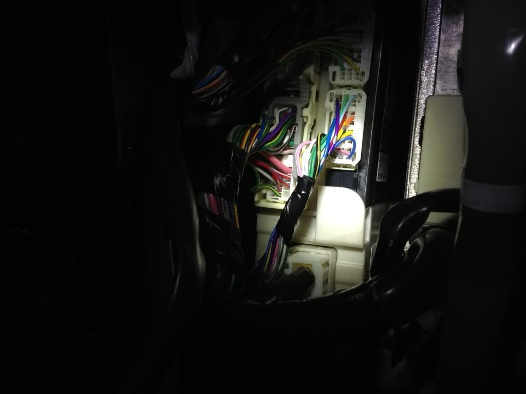

Picture of the wiring. Connector bottom left. Count up 3 slots then to slot 5.
And they ouptut voltage with the fog light switch on and don't when the switch is off. The hardware is in the ECU and functions!
With the switch on.
Worst case you tap into the wiring here but they have to have another end somewhere and I'm betting its under the hood. Finding them is the next task.... back to the manual.
This is tooo easy!

No, just plug up the stalk. Don't do anything with the white wire running in that circuit. When you turn the switch on the stalk it grounds that circuit and energizes everything. You get fused power out of the white/red red/white wires I have pictured above and the indicator light in the dash.
You don't need any more relays. Just tap into these wires and run them to each individual fog light. Ground the lights somewhere near them.

May have found the wires. I'm gonna have to hit the auto parts store or stop by work and pick up a wire probe. Not going to cut into the harness until I'm sure these are the right wires. According to the schematics/wiring manual they should be run to this area. Right next to the fog lights.
