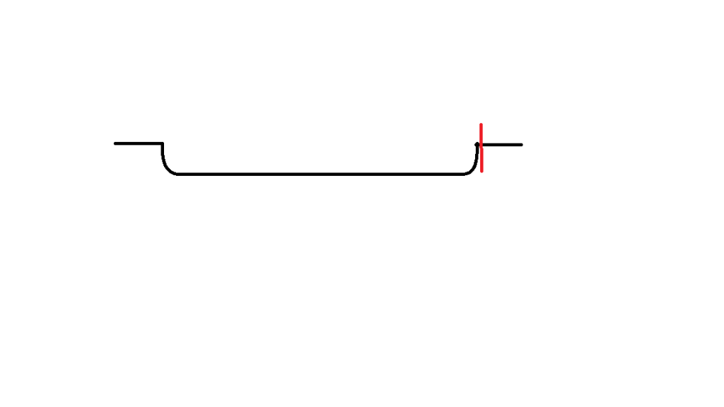

The way the hitch fits in here either the bumper bracket or the crash beam would need to be trimmed. You can see in the pic below. With my design I opted to trim the crash beam and clear the bumper bracket. (this pic is before trimming)
This is the side profile of the crash beam flange and the red line shows where it must be trimmed. This part of the flange is only there because of the stamping process and is about .25"x4".

I ended up trimming my bumper bracket the same way. Glad to see I'm not the only one.
