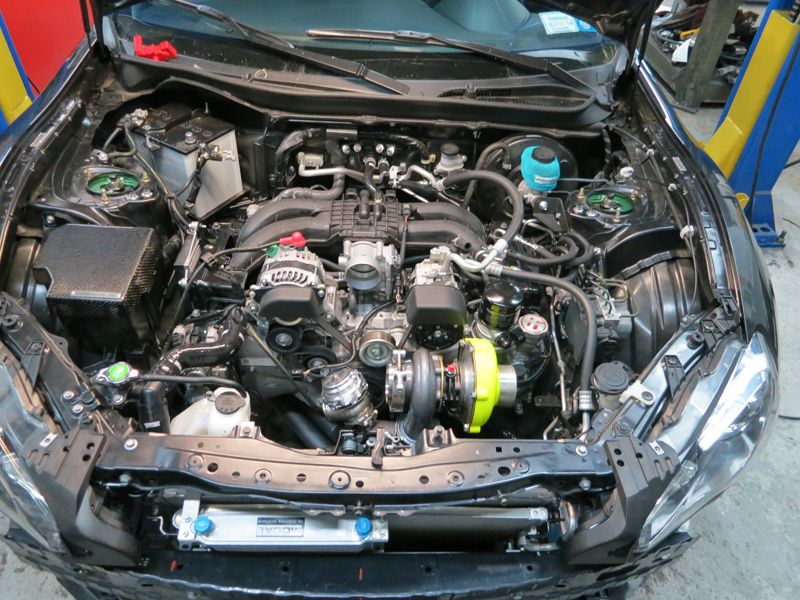

This is about as good as it gets... I would take more for you but the bumper is on and hopefully will not have to come back off.
It is just sitting in between the AC condenser and bumper beam, resting on top of the intercooler. Than we made those little brackets on top and attached it to some metal tabs on the radiator so it cannot move around. There were only two options of where to put it. Where it is currently, and behind the passenger fog light which would require longer lines and a much more complex bracket system.
Parts used -
Mocal thermostatic sandwich plate, 19 row oil cooler, 2 - 45 degree 10AN fittings, 2 90 degree 10AN off the oil cooler, and a whole bunch of 10AN line.
If you do not want to have it sandwiched in between the bumper beam and condenser you can use a 16 row core which should be able to sit on top of the bumper beam. We tried that initially but the fittings on top hit the radiator support.

I was actually able to fit a 25 row oil cooler between the condenser and the intercooler. It required some spacers to move the condenser and koyo radiator back a bit, but it worked well.
