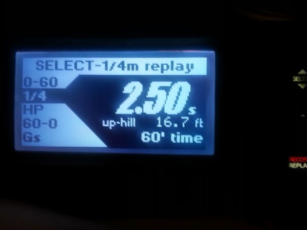

60ft Time- Notes: Very subpar, but with the cold tires and cold ground and "skinny" 245 Hankook Ventus tires, it's decent. With a better setup that can actually hold traction, the launches would be much much better.

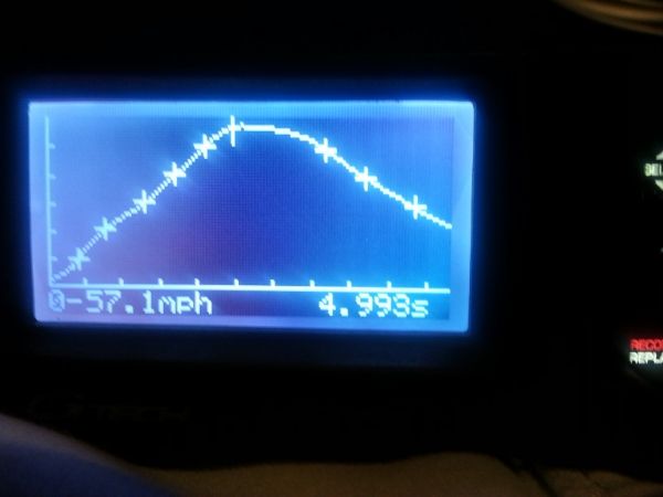

0-57mph- Notes: This is as close of a 0-60mph time I can get for the forum. Again, this is with a 2.5 sec 60ft with cold summer tires. Once the weather warms up and I get fatter/more aggressive tires in combination of a raised 2nd gear rpm limit, this car should do <4.7sec 0-60mph.

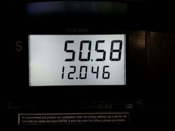

Gas Mileage- Notes: This tank was done with mostly "normal" driving. "Normal" driving can be summarized and defined as 10mph above speed limit in both highway and city. This is actually the same tank that was used for the 0-57/60-100/60-120mph testing. This is a calculated 25.96mpg.

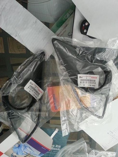

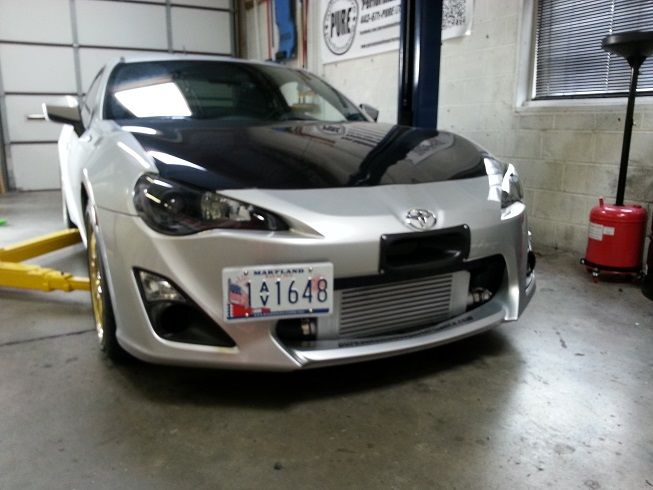

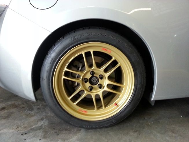

3/8/2013 Update:
- RPF1 staggered setup w/ BFGoodrich KDWs- 255 on 17x9 rear, 235 on 17x8 front
- 2.75" Overpipe-back exhaust- J2 Engineering test frontpipe mated to Greddy Evo3
- Front grille removal w/ Perrin license plate relocator
- Custom intake air inlet
- GT86 Fog bezels

Updated with 60ft, 0-50mph, and 0-57mph times. This is using a GTech Pro.
