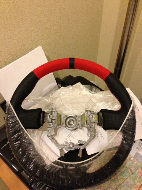

Installing mine tomorrow! Can't wait ><

Originally Posted by DSOmegaX View Post
Attachment 39121
