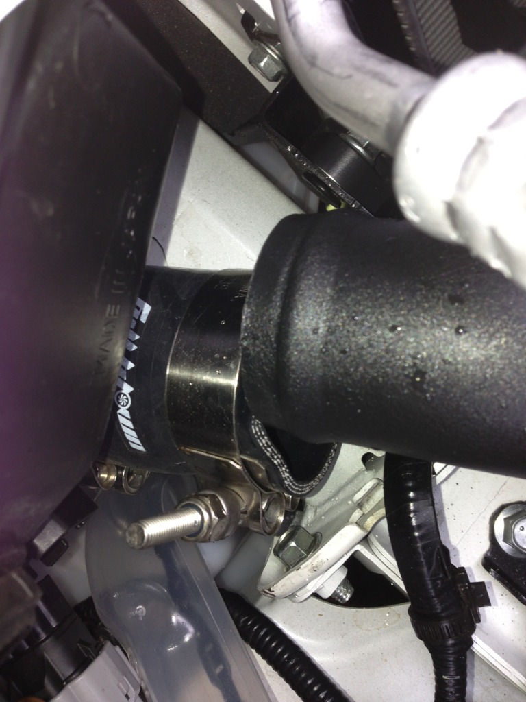

This happen twice today
Will fix it tomorrowName:  ImageUploadedByTapatalk1369009596.684146.jpg
Lookin at that clamp and the fact that it looks fully compressed, my guess would be that you don't have the right size T bolt clamp for that size pipe/coupler. Full Blown did not do a very good job sizing clamps for this kit as I have a couple that are fully compressed as well. My recommendation is measure it and order a slightly smaller one or find a shop that has them locally and get the next smaller T bolt clamp for that hose. Also, make sure that the pipe is far enough into the coupler that the clamp is behind the bead rolled portion of the pipe.
