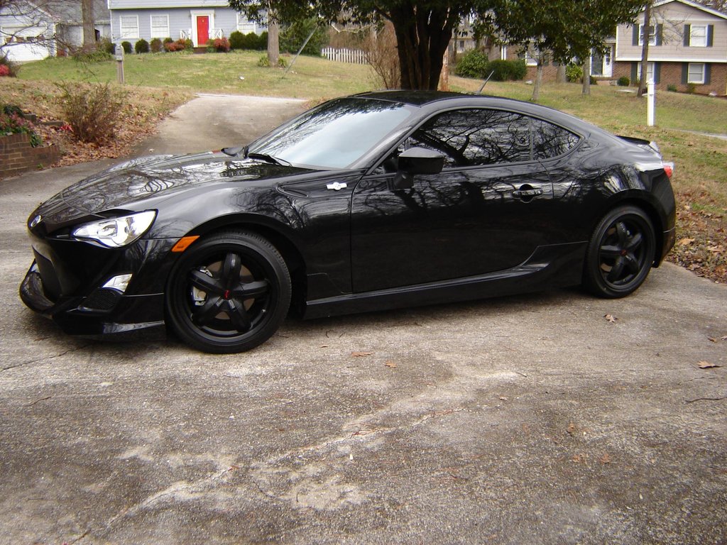

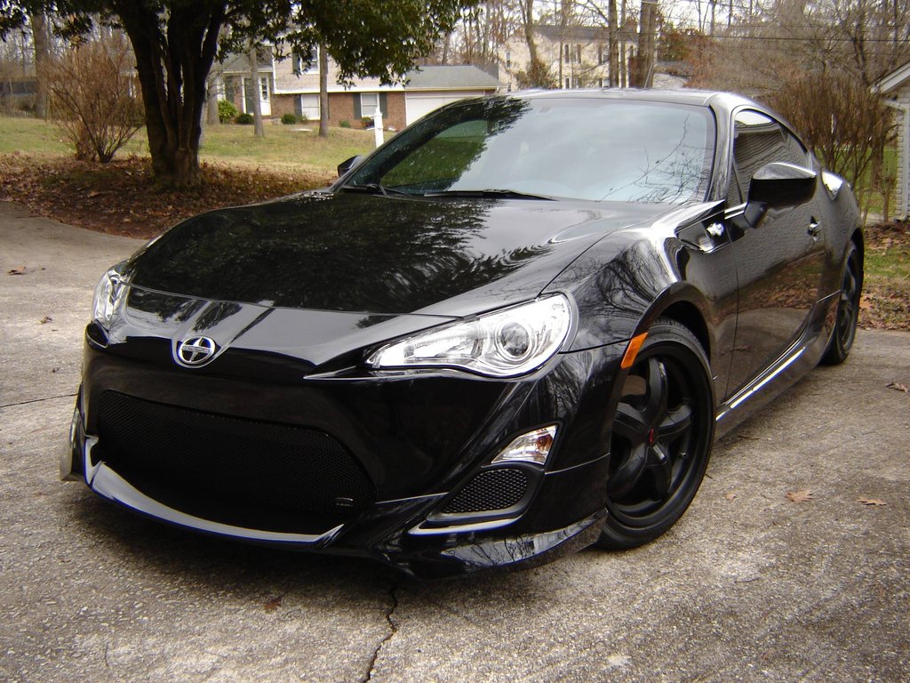

Apologize if these sizes have been touched upon before - wheels really aren't my specialty. I'm considering the Platinum Widow 18"
Brand_____ Platinum
Model _____Widow
Item Weight______30 pounds
Product Dimensions_____18 x 18 x 8 inches
Exterior_____Matte Black with Gloss Black Inserts
Manufacturer Part Number_____212-8818B
Construction_____1-piece
Rim Diameter_____18 inches
Rim Width_____8 inches
Bolt Pattern (Number of Holes)_____10
Bolt Pattern (Pitch Circle Diameter)_____100 millimeters, 4.5 inches
Offset_____42 millimeters
Backspace_____6.15 inches
Hub Bore_____73 millimeters
How would these fit on stock? I may lower in the future, but not by much.
EDIT: I would also likely get 225/40 tires - would this work as well?
