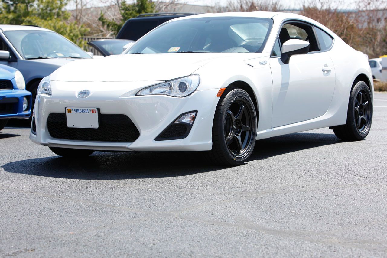

Originally Posted by Nhil View Post
Looking at a 17x9 wheel with a +42 or +45 offset and a 245/40/17 tire with stock struts and RCE yellows. Will I have rubbing issues in the front?
No.
17x9 +42 Mach V Awesome, 245/40R17 Direzza ZII.
