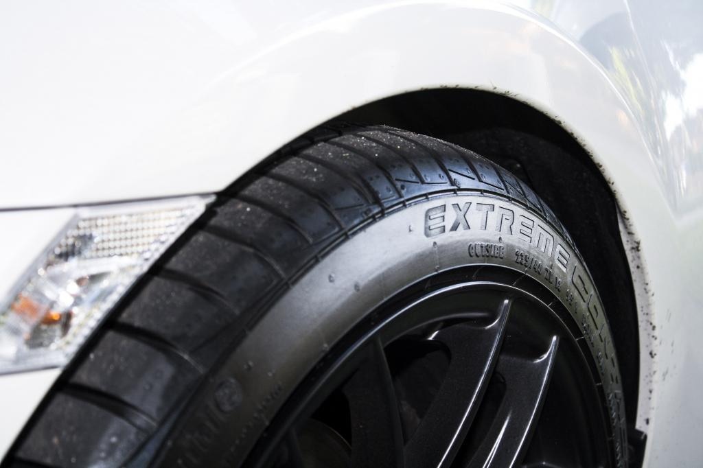

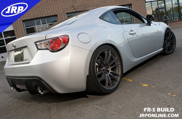

Example of 'rounded' profile (this is my current setup) (235/40/18 + 18x8.75):
Example of 'squared' profile (not sure what this setup is):
Attachment 35535
Attachment 35537
Stretched fitment most likely. Although it can also be the design of the tire.
