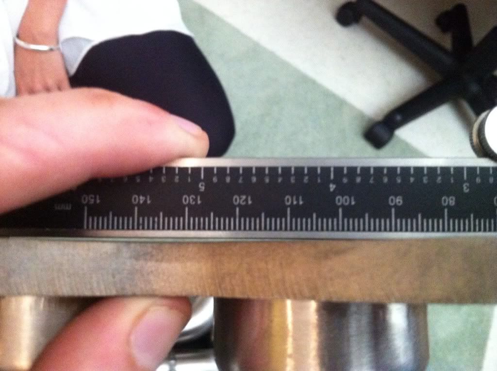

Ended up un-warping my borla header flanges without taking material off.
With about 2 minutes of work on a cheap 12 ton press, I got one flange absolutely perfect, and the other one from .065 low in the middle to only about .009 (which I will work on a little tonight to get perfect)
It just so happens the header design makes it perfect to mount on a press to get flanges flat. Have the ears of the flange supported while you apply pressure to the flange between the pipes as close to the center as possible.
The press barely flinched getting the flanges straight, just did one pump past contact with the header flange and that seemed to do it.
Didn't even mark the header flange, header still looks brand new.
I hope Borla doesn't void my warranty by fixing their parts

Its hard to see exactly how much is warped, so I used feeler gauges
Before with ~1.2mm gap
After with less than .2mm gap (smallest feeler gauge would not fit, cannot confirm exact size but it is basically nothing)
A few more minutes on the press will yield a perfect flange, both of mine seemed to bow inwards in the center as do most of the other examples I see on the forum, and the press takes care of it almost instantly
