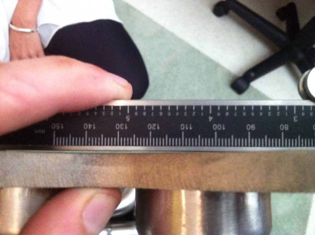

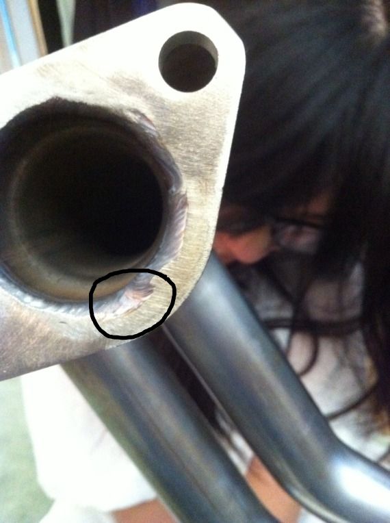

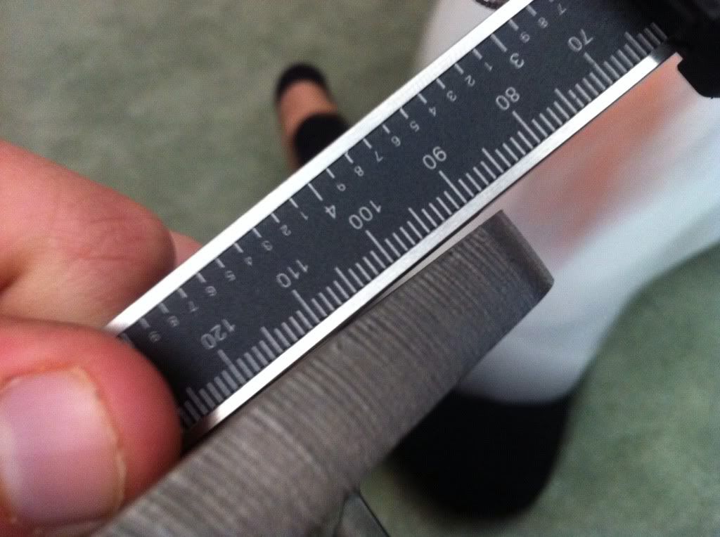

Got my replacement header in today, first thing I did was check the flanges...
The 2 bolt flange is pictured here, the bolt ears are warped outwards, and the pipe inside is actually sticking out PAST the flange about .35mm
In the second picture you can see the pipe sticking past, and you can also barely see it in the first
The other side of the flange
This isn't too bad, I think it should seal up.... but still, flanges should be FLAT.

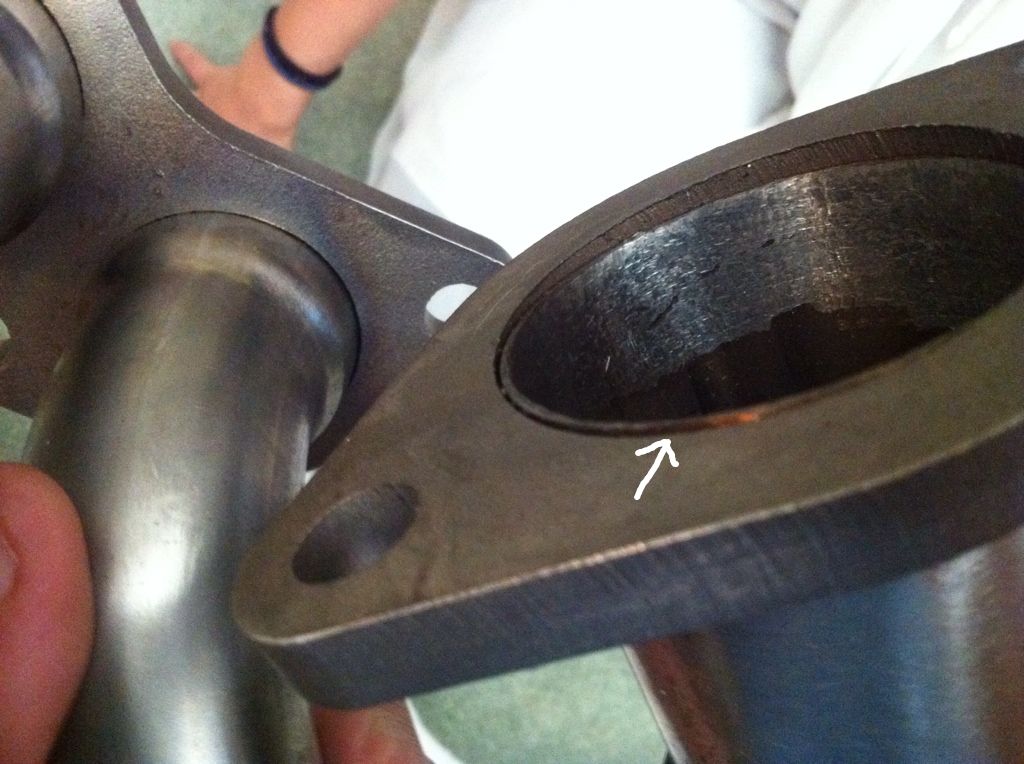

This concerns me, I do not have any gaskets to test with, but it almost looks like this area that has been ground down is very close to where the fire ring on the gasket will seal.
Opinions... should I try to run this or ask for another replacement?
::edit
Another fun fact, the 2 flanges that bolt up to the head are not even. If you place the header flanges down on a straight table (marble, thick glass, etc.) one flange will lay flat on the surface and the other one will only have a corner touching. The flex pipes will take care of that I suppose, but it makes me a little dissapointicus as the flex pipes will then always be "tweaked" to take up the insconsistancy
