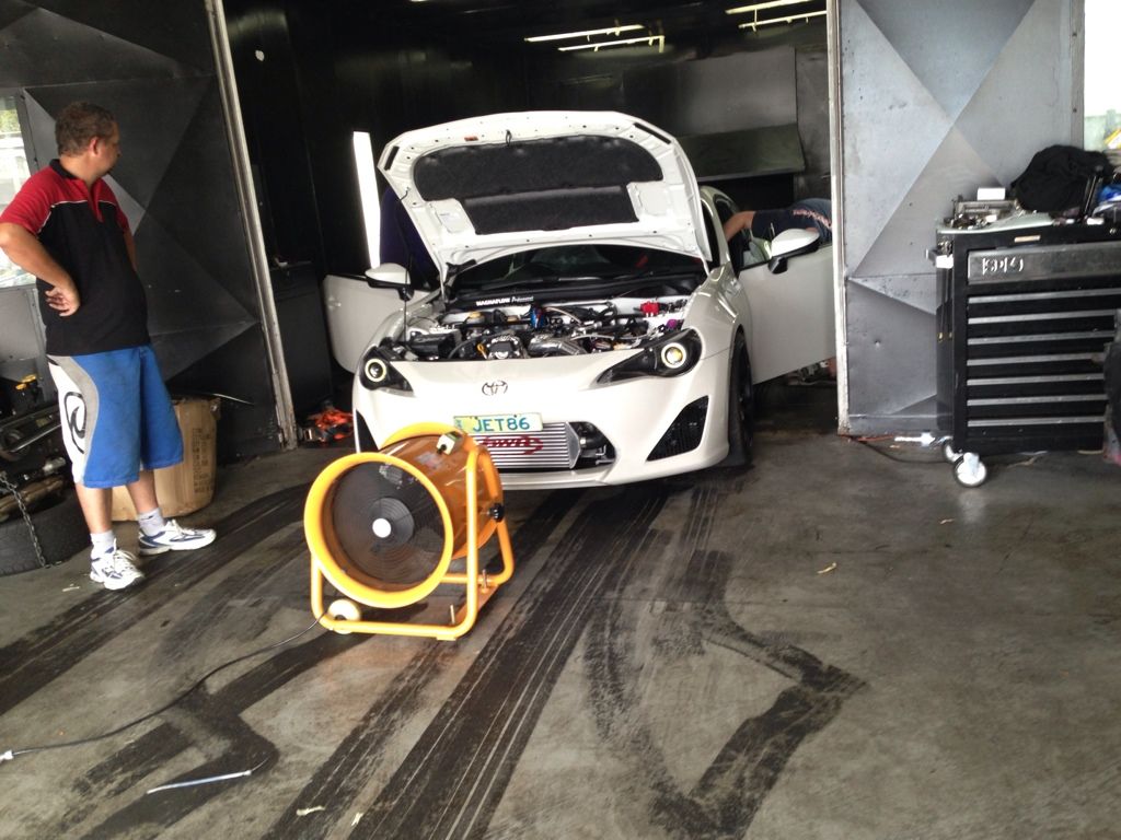

So after a day of taking everything off to use new sealant on the sump, everything is back together and I've been sending logs off to Visconti and have got a pretty good map that I'm running now. The cars pretty fast, and by pretty I mean very. It's amazing for just 7psi. It feels the same as 20psi in a factory turbo car lol.

Here's what I did yesterday afternoon.

Here's a video of th dyno run, it's the first pull we did just to check AFRs. It needed a little more fuel up top so we didn't really push it today.

So on 7psi (wastegate spring pressure), stock exhaust and half a tune, it still managed to pull 209rwkw (284rwhp). Should be interesting what we will see once I receive the grimmspeed boost controller running a few more psi and finish building the exhaust. Maybe around 250rwkw?
