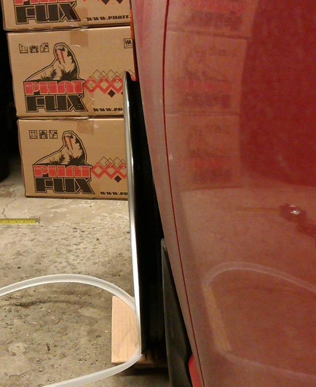

Slick
Slick's Avatar
Join Date: Jul 2011
Drives: FR-S Firestorm 6MT
Location: Ottawa, Ontario, Canada
Posts: 1,881
Thanks: 345
Thanked 1,389 Times in 628 Posts
Mentioned: 137 Post(s)
Originally Posted by itdansharpe View Post
I just got a warm tingly feeling. Glad to help!
I'll be test-fitting my setup again on the weekend on both front and rears. 18x9 +35 square
The weird thing is that according to your fitment calculator, I should be 4mm in, but instead I am about 20mm out. See pics.
I also know many others have fit 17x9+35 and also 18x9+35 without issue.
I going to recheck the offset and stamping on the wheels to be sure they are indeed +35.
There is about 15mm clearance inside to the strut which makes sense on a 9" wide +35. (I heard that a +45 almost hits the struts)
I guess we'll see.

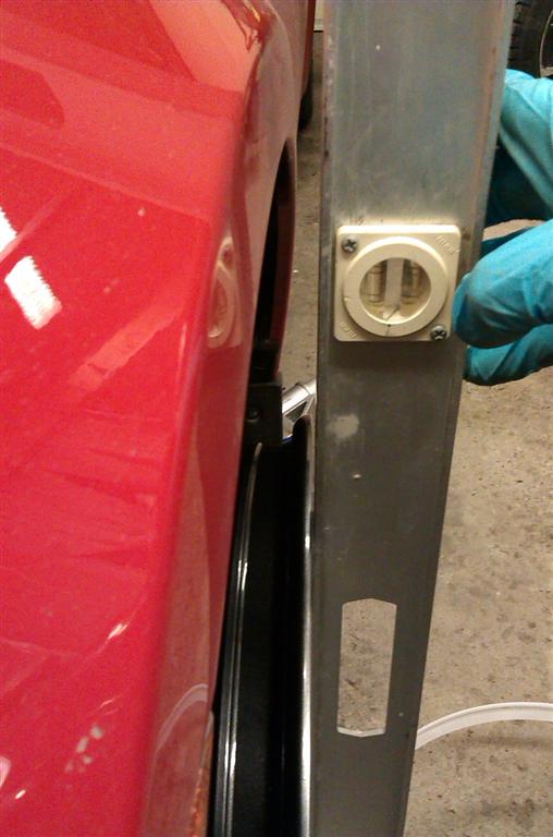

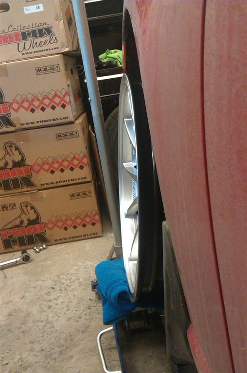

Slick
Slick's Avatar
Join Date: Jul 2011
Posts: 1,881
Thanks: 345
Just a follow-up to my post from a few days ago, I tested fitted my wheels again this time on both front and rear. (18x9 +35)
To give you a visual of how much camber you gain with crash bolts on the front suspension, here are some before/after shots. I didn't actually use crash bolts, I just pulled the OEM upper bolt out enough that the larger shank was out.
First 2 pics are before, next 2 are after the camber bolt adjustment. Spring is compressed to stock height both times for proper reference.
End result is that it will fit with the crash bolt installed.
Lowering springs should add a bit more camber that will also help for clearance. (ProKit on the way)
