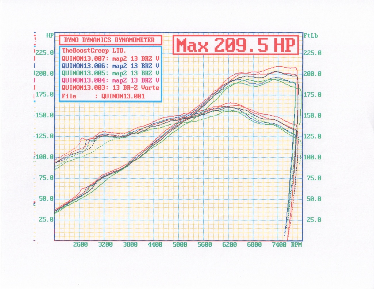

I ran Perrins tune for a long time and never had any knock. Here is my dyno sheet with their tune. the max HP was with a aggressive tune they had. and none of the dyno pulls showed know on the logs.

skatery1989 is offline   Reply With Quote

OK. What caused the dip you have at 6800? That's a pretty big dip (RPM wise).

Colorado 5280ft. I am pretty sure thats timing being pulled away. Ill look and see is i still have a log I can post for you to see theres no knock. I have hundreds of them saved right now.
