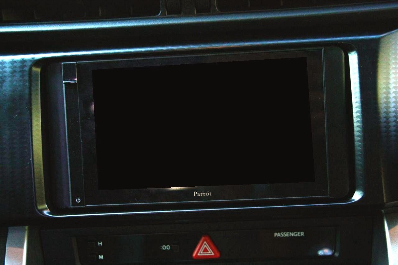

Thanks, I was up until the early morning hours installing it - ran into lots of issues. Check the time on the one photo.
Big thanks to @GeeTee86 for the help as well.
Paid R8799 and SMAC's got stock but they didn't have a demo. I can promise you though, it's well worth every cent. Came with iGO and SA maps as well which is nice but I've already installed TomTom.
It doesn't fit as nicely as the Chinese radio but I don't mind too much to be honest, the functionality and ease of use makes up for it. Sounds great too!
The fitment looks something like this:

I;m not happy with the way it fits to be honest, I'm looking for a nicer bezel. Will take some pics.
The wiring is actually the easy part - you can get a harness adaptor then it's plug & play. Getting the radio itself to fit is actually quite a mission.

Okay, turns out I'm useless at taking pics of radios - it's damn difficult with all the glare.
The LCD looks skew, it's not - it was me ms-painting a big black block over the glare.
