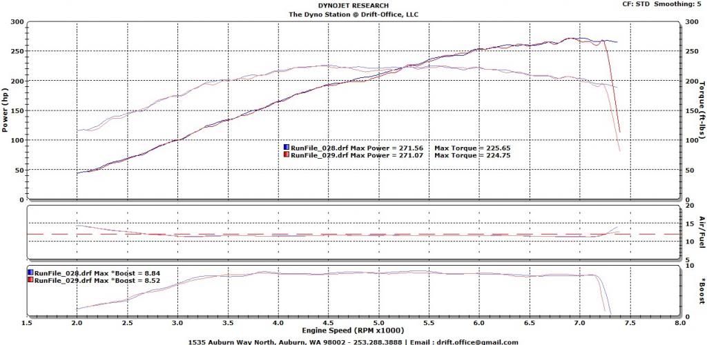

Here are some larger pics... For the sake of argument, I'm also posting those specific runs in STD Correction, since some have resorted to using that as a basis of comparison...

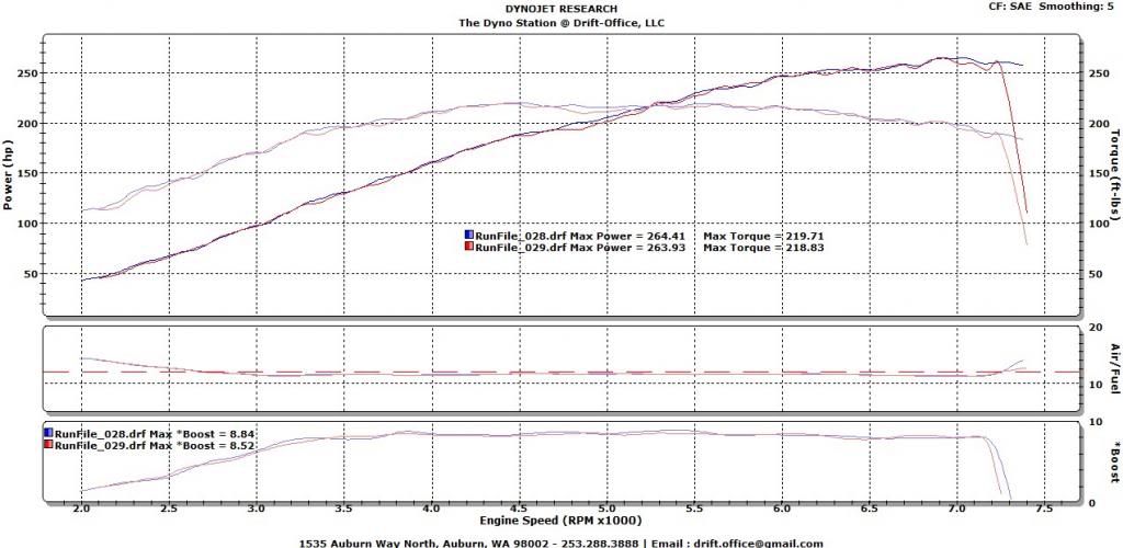

and again now in SAE , enlarged.
That way you can see it isn't that much of a difference, but enough to skew the numbers ever so slightly, possibly to sway an opinion one way or the other. Aside from the larger and heavier wheels that were on the car, I also noted based on the logs that the quality of gas wasn't as seemingly as good as we might have hoped but in anycase, this would be pretty representative of the 8 PSI requirement now set forth by the SC contenders...

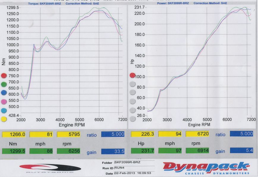

And just for giggles, here's a dyno run from a DynaPack dyno (reads at the hubs) from a HKS SC Kit (Version 1 I'm told) @ 8 PSI as well... 230 WHP @ the hubs...
