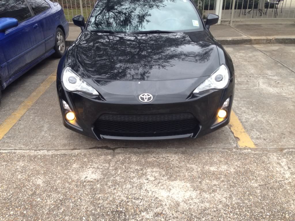

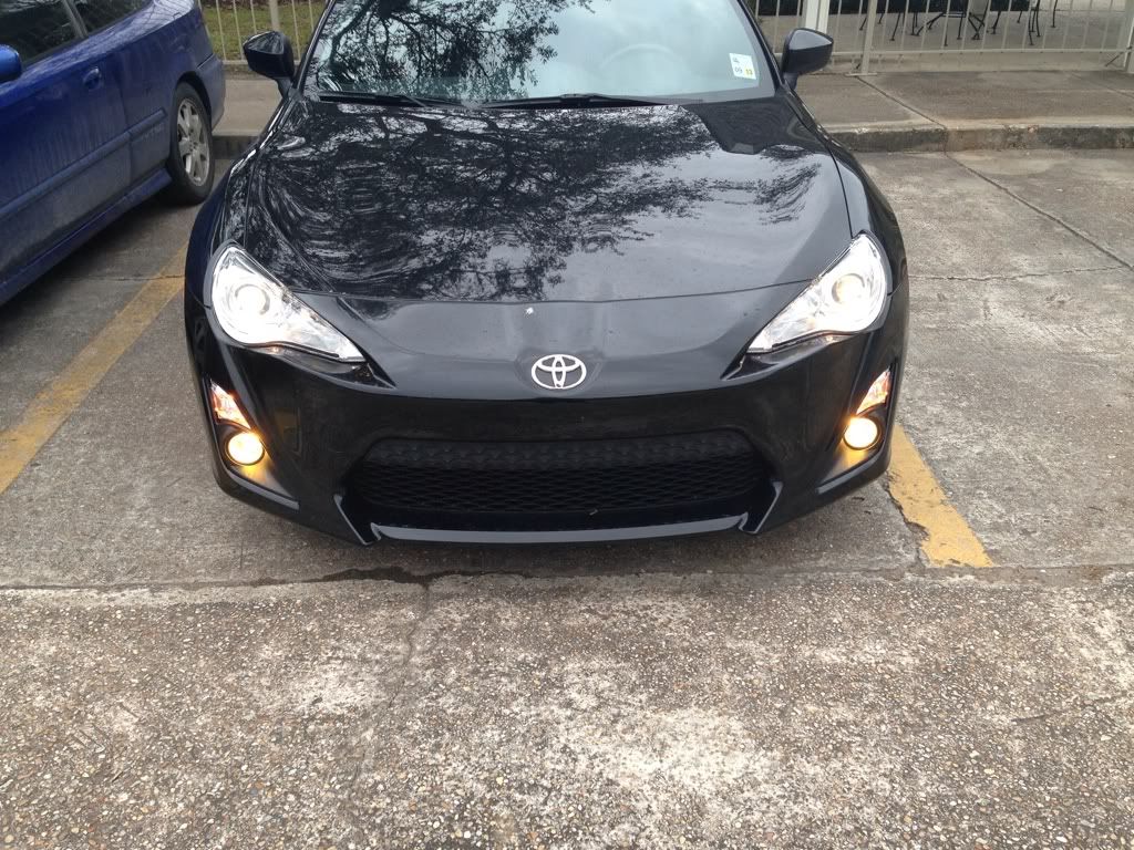

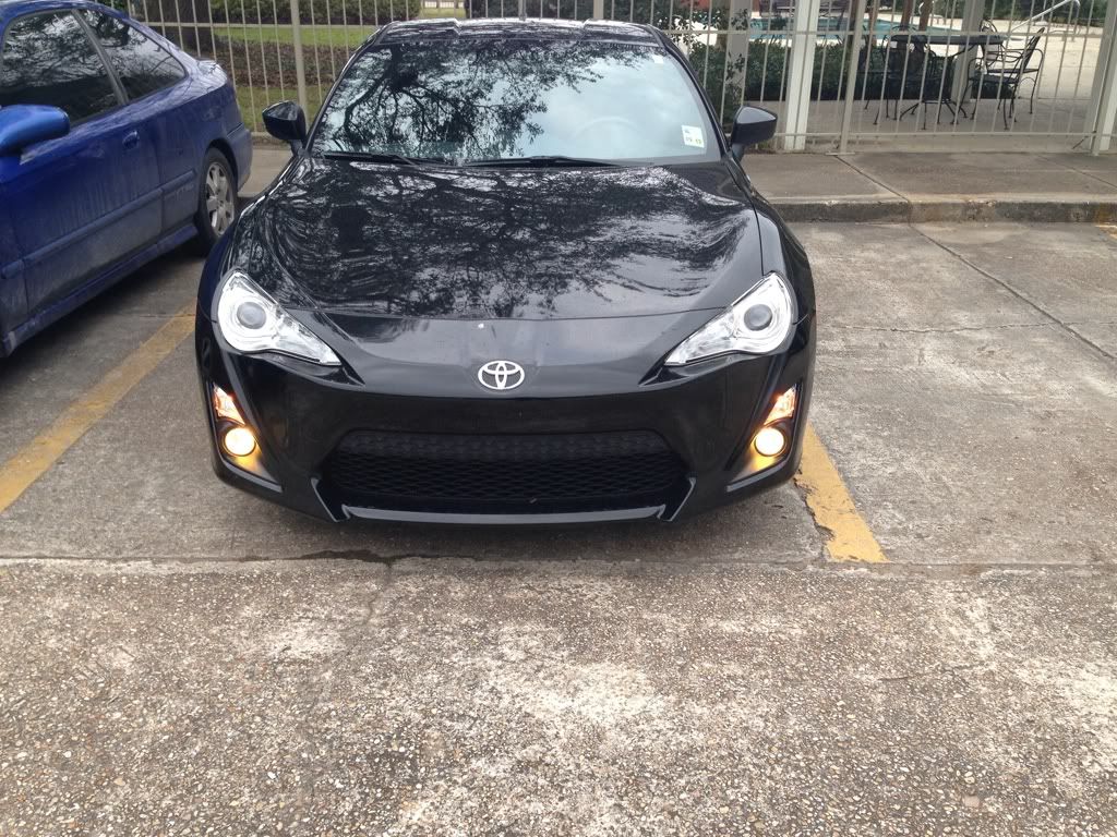

Posts: 423
Thanks: 87
Thanked 107 Times in 68 Posts
Updated the original with a few more pics. Here are also some with the lights.
