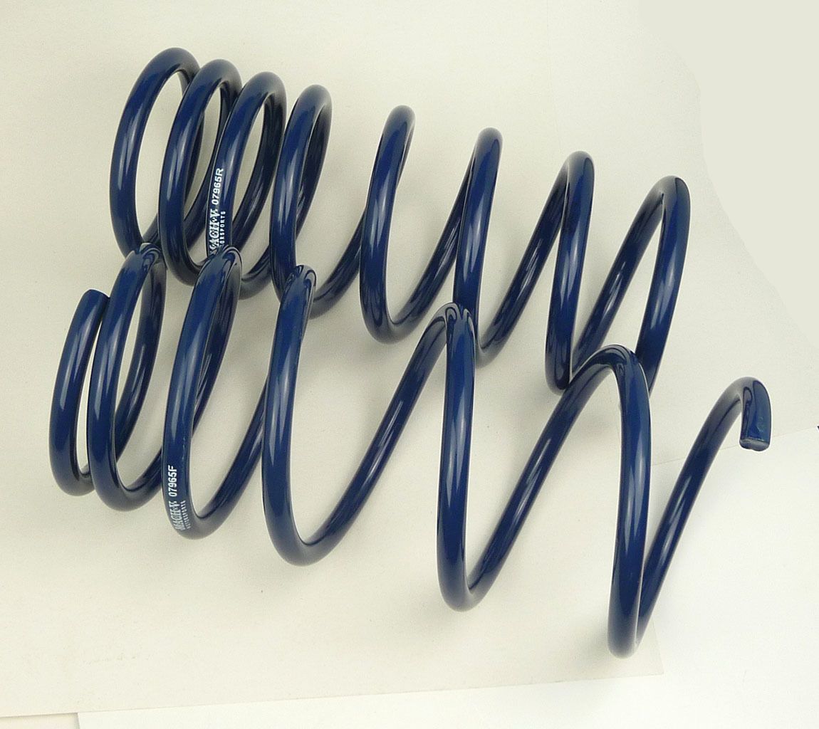

Originally Posted by uspspro View Post
Some of the springs out there are only progressive just to take up some initial drop and be captive, then the rate is linear.
It's going to be difficult to make a spring that's completely linear, AND that lowers the car. If you just shorten up the spring and firm up the rate, then it won't be tight in the suspension at full droop. The result would be a spring that rattles every time the wheel drops into a hole.
To keep that from happening, you wind in some lower-rate coils that will be fully compressed (or "dead") when the car is at normal height. Then when the suspension goes to full droop, the spring will stay snug and won't rattle around. Some coilover suspension systems use a lighter-rate "helper" spring for the same purpose.
As you can see above, our springs have close-wound coils for a bit, then wider-spaced coils for the bulk of the spring travel. The effective rate that the suspension will see under normal use is linear, but the spring is not uniformly wound. Most, if not all, the aftermarket springs I have seen for this car use that design.
I guess that's a long way of getting to the point that it's not so simple as saying a spring is "progressive" or "linear."

Our springs are linear at normal ride height. There is a progressive section that kind of acts as a helper/tender spring but we wanted them to be as linear as possible.
EDIT: wow, Mach V Dan answered around the same time in a little more detail. Well put.
