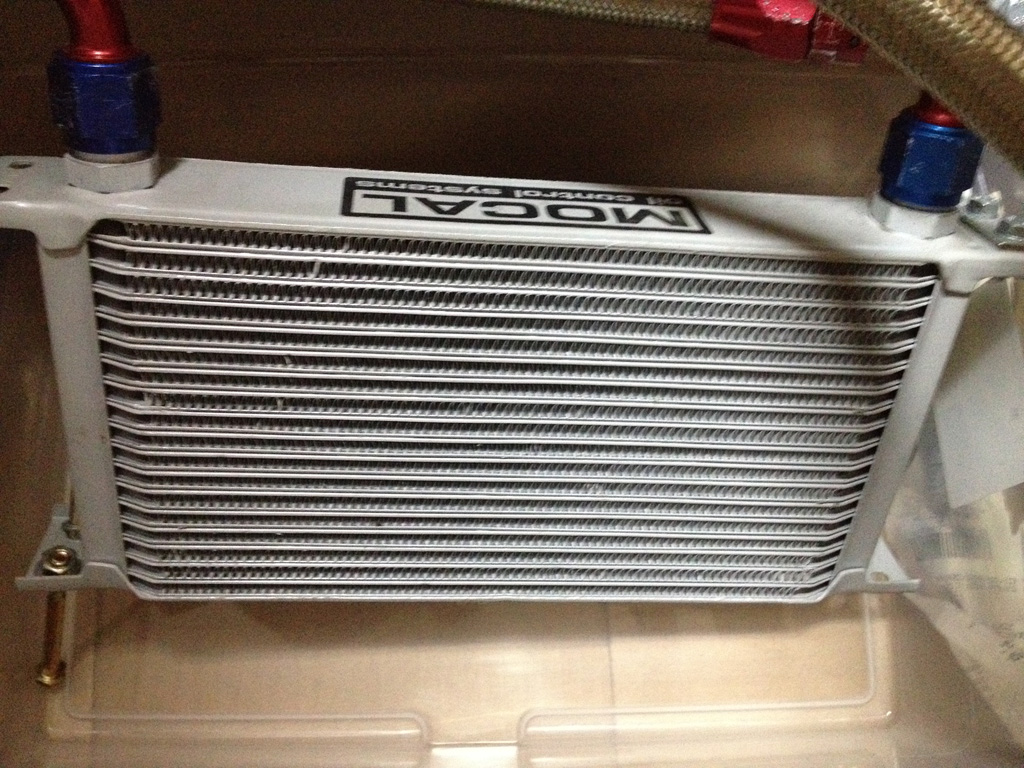

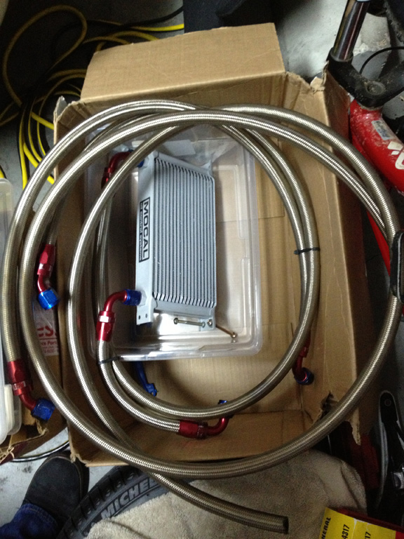

Some parts sitting in a box
Cooler itself (19 row Mocal 235)
Once I get some other parts in I'll start test fitting this larger cooler (so far everyone else is running a 13 row I believe) and start measure hose lengths, etc.
