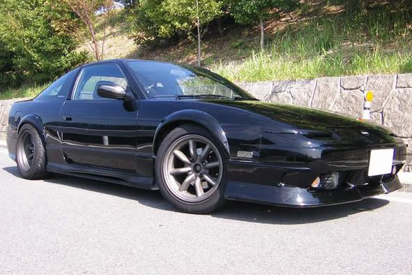

got a wheel fitment question, you guys think this would fit? ^^

Originally Posted by 2point0 View Post
lol, you didn't mention the 4 lug holes
uhmm
http://www.watanabe.com.au/page3.html
16x8 +0 4,5 or 6 98 to 139.7 7.5kg
you guys have been real helpful though!

Originally Posted by meeks View Post
uhmm
Ok, just making sure. That offset will stick waaaay out. Zero offset means the hub face is directly in the center of the wheel and as a comparison, stock offset is +48mm, which means the center of the wheel is 48mm inboard from the hub face.
Zero offset is something you'd see on old muscle cars (like my 'Stang). for an 8" wide wheel, you'd want to stick with something in the 35-45mm range, depending on how aggressive you want to get (more aggressive = wheel sticking out more).
You'd also need to be sure the wheel comes in 5x100 bolt pattern.
Looking closer, all the wheels on that page are 0 or negative offset. They are not meant for these cars.
thanks for the answer. i guess the other guy didnt understand that it was just a picture for reference thats why it had a 4 bolt pattern on it.
your answer contradicts one of the vendor's answer to this tho, see below:
Originally Posted by Touge Factory View Post
Definitely won't need over fenders for that.
16x8 +0 should be able to fit without much issue. Would be even easier if the car is lowered on coilovers.
excuse the overfenders but hoping some functionality/looks to this effect (picture as a reference..again mmmmkkk?)
I have a hard time believing it'd come close to fitting. Nissans like that can take a really low (0 or negative) offset like that. That setup on an 86 would push the outside of the wheel about 2" out from stock. Go check that with a ruler/tape and see if it's what you want.
For reference, my wheels are 17x9 and +28mm offset. They stick out too much for my tastes, especially with semi-wide tires. Negative camber would help there, but still not what I'm ultimately going for. To compare, my setup sticks out roughly 1" from stock.
This is a handy comparison tool: http://www.rimsntires.com/specs.jsp
