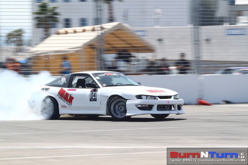

I would say some federal 595 17-225's max with stock horse power. I drifted most of the autocross i went to the other day and the car did great because is was a 1st-2nd gear course but the stock car will have problems with 3rd gear unless you knew what you were doing.
I ran 17 235 rsr front and 17 245 in the rear with a 300whp made to drift car and it produced OK smoke but the motor couldn't bounce rev limit in 3rd unless they were super aired up. The 161whp FR-S is going to have hard time spinning 225 in 3rd enough to produce smoke unless you're really beating the hell out of it. However to just slide around and practice they'll be good that's the tire I would go with. They'll last for days.
For reference these are 17 245 fed 595 at the top of 3rd but the engine doesn't have enough power at 300whp to bounce rev limit. But it sat 500 off redline for the whole sweeper at WOT.
If you're a beginner get another set of 215 or 205 economy tires and spin those for days while you learn.
