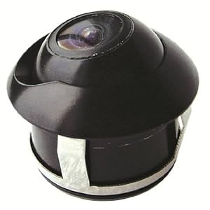

Originally Posted by Furtive View Post
i just bought a boyo vtk360 .. hopefully it will work.. specs on it seem a little bit better than the boyo you bought xcelir8br
..also which link on ae64 is the right cord for the brz ?
I haven't ever seen a camera like this but from the looks of it I would guess this is made to mount in a similar manner to parking sensors. The white part is the same type of holder used on a lot of parking sensors and the angle of the camera looks relatively flat, like it would sit flush with your bumper and basically aim straight out.

Big hole required. Won't for in OEM location. Swivel equals more to break and water penetration.

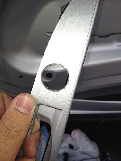

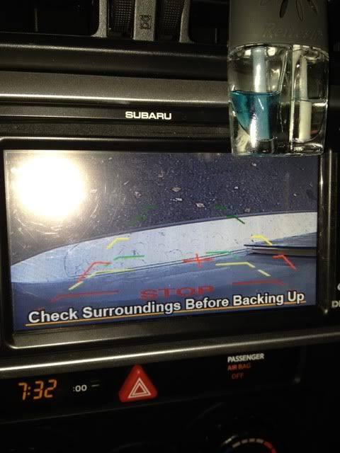

The hole required is actually not that big. I'll post some pictures up tommorrow. The only problem is the angle isnt right (and being a nooob, i drilled the hole before actually testing it out -_- (i figured it 360 swivel meant 360 swivel...i was wrong).
One issue I'm having with the boyo is I went ahead and cut the blue wire and the guide lines are still there. You purchased a boyo right?

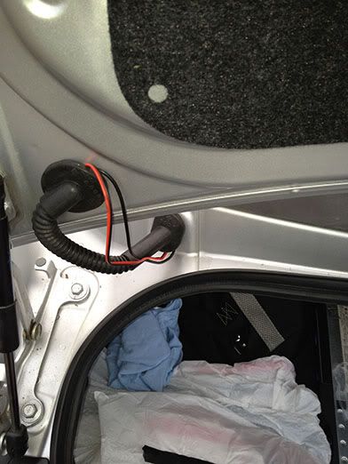

**ISSUE** -- i cant get the view angle adjusted , and guide lines are still there I've cut the blue wire ...
**Question** how did you guys hide these wires I feel like water wil get in if i leave it this way...
** soo.. upset I didnt test out the viewing angle.. now i have to deal with this big hole.. XD or find a camera to replace it..
*update* so I went ahead and bought a new one... hope this fits the hole I just made and angle is a bit better..
Looks like that camera was designed to be mounted on a vertical surface instead of a horizontal one. As for the guide lines, not sure as my Boyo ultra slim didn't come with guidelines. Only option I had on it was image reverse.
Snake it through the black rubber sleeve, not outside of it.
