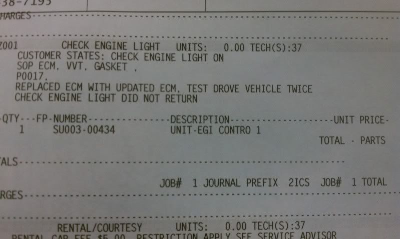

Originally Posted by OmarGC View Post
Soooooo..... After 24 days I have my car back. Here's my "fix"
Throwing on my suspension, other wheels/tires on, oil change, alignment then have a trackday at Gateway Motorsports Park Wednesday.
Thats it, I'm showing this picture to My Toyota shop and ask them to use that number in their computer and see what shows up!?
