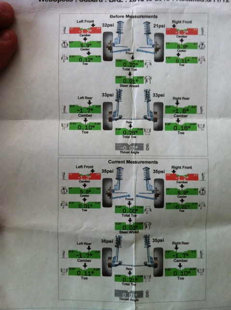

-OEM crash bolts
-Stock wheels w/ 225/45/17 star specs. -Sheet attached below. Name:  ImageUploadedByTapatalk1344816683.237434.jpg

Originally Posted by NYC BRZ View Post
-OEM crash bolts
-Stock wheels w/ 225/45/17 star specs. -Sheet attached below. Attachment 12696
Picture of me and QuikJ. Mine was done and his was going on the Hunter Hawkeye at RCT Performance in Queens, NY. He elected to go with 215/45/17 star specs.
Forgot the pic. Lol. Name:  ImageUploadedByTapatalk1344817247.464339.jpg

1) what is the torque setting for the crash bolts?
2) after installing crash bolts, do you adjust for max camber you can get? This is for a daily driver and autox

You wont get more than -1.5 camber likely so it is plenty for DD, just get the car aligned after, get that toe corrected.

torque on the front camber bolts is 115 ft./lbs.
