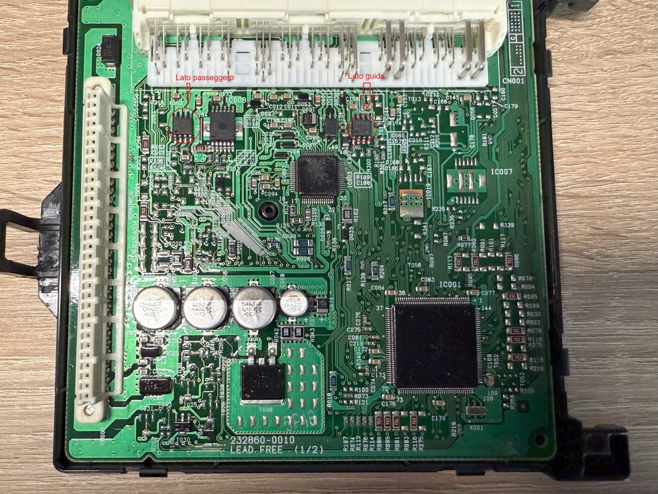

As you well know, SOME sections of the system are not fused and the mass (G) is instead managed by IC.
In this case, the Map Light, Door Courtesy lamp and Sun Shade Light section, electrochromic mirror (who has it) has the mass managed by the Integrated Unit which has a different code for each Model Year (starting from the final 88281CA500 up to the 551 of the Model H for EU LHD Models). I'm talking about Subaru codes, but the unit with different code is the same for GT86.
When you short out, for example, the door lights (door courtesy lamp) or the ceiling light (Map Light), it is unlikely that the fuse blows, but rather the IC on the motherboard of the body computer.
In particular, the IC you see in the photo (one for each side of the car , driver and passenger) which is called A1764 (213 is THE MANUFACTURER) is skipped. This IC is also present in the ESD system and in the ABS control units and manages the actuator solenoids.
Generally, when one of the two is burnt out, the map light timer and the light on approach functions with the keyless are lost. Sometimes if it is not completely burned it causes the door courtesy light not to turn off.
Without spending hyperbolic sums for INTEG UNIT replacement, among other things there are many on Ebay, just a few cents are enough to desolder the old burned IC and solder the new one.
Everything will come back again.
Last note: if you don't want or don't know how to replace the IC and find the component used, two precautions should be taken:
a) It must have the same code, the fuse box is common to all;
b) If you find it as a Toyota and you have a Subaru it will be customized as a Subaru via SSMIII for Subaru BRZ up to 2016 and with SSM4 for after 2016.
