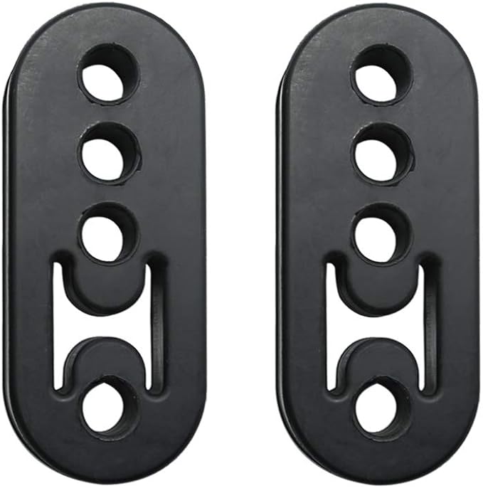

You can also adjust how it hangs by getting slightly longer polyurethane hangers, which may put a little space between the tips and the cutouts.
Can confirm - on my old catback setup I had the same issue with the right tip sitting significantly closer to the bumper opening compared to the left tip.
Swapping the two right hangers to these extended-style hangers which have multiple holes for some adjustment sorted it out.
